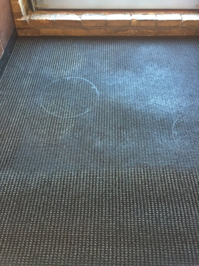

Is it possible to stop your hydro force from dripping? I release the pressure before I disconnect. I used flex w citrusolve and attack 360i with commercial carpet head. 220 degree water. I am loving this new setup!

I'm sure it's possible, but it's probably more trouble than it's worth. Just learn not to disconnect it over wood floors.

No wonder you enjoyed cleaning that restaurant. High pressure portables can do surprisingly good work, but nothing cuts food grease like heat.
My experience seems the older the gun the leakier they get, replacing it with a new one will help. I've got an old one that I drain after the last area on the job is presprayed. Disconnect the solution line, keep the gun triggered and use a flat area on the gun to depress the nipple on the male qd, its amazing how much fluid will leak out, better on the uncleaned carpet than in the back of the van.

I agree. Thanks for the tip
