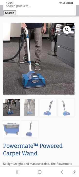

Lol I mean on very heavily soiled carpet.
I was thinking a 15 inch crb in a housing with a bunch of jets hooked to a truckmount vacuum. Dare I say a vacuum front and back with large slotted glides.
It would be the ultimate drag wand. Even put some wheels on it to make it a push pull system.
Probably one out there already but I couldn't find anything on a quick search.

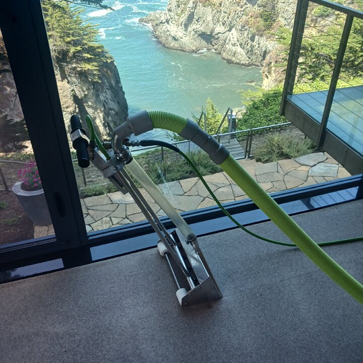

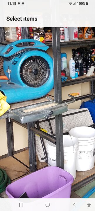

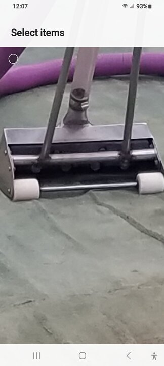

About 3 or 4 months back someone posted a picture of a powerhead just as you just explained . It was built in Italy and was about 1500.00 ill be damned if i can find it now or any info. I actually found one on ebay back then . This is what i have but it doesn't have a brush there are a few portable machines that have an attachment like you described
Mine is, 16" wide, 4jets, zinc weighted, itll pickup virtually everything it puts out even at a stand still . Only has single vacuum slot though

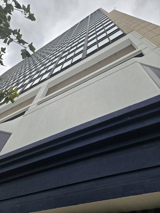

Good to know. I fit the Cimex, my 175, 2 large snail fans, Multisprayer, rolling cart, and a bunch more on the floor in the back of my van on my big commercial day. It was stuffed though. I couldn't of done the big job with a trailer. Big apartment building in metro Hartford. I could barely fit my van near their loading dock on a busy street. I hope they have me back to clean the other 15 floors :]
