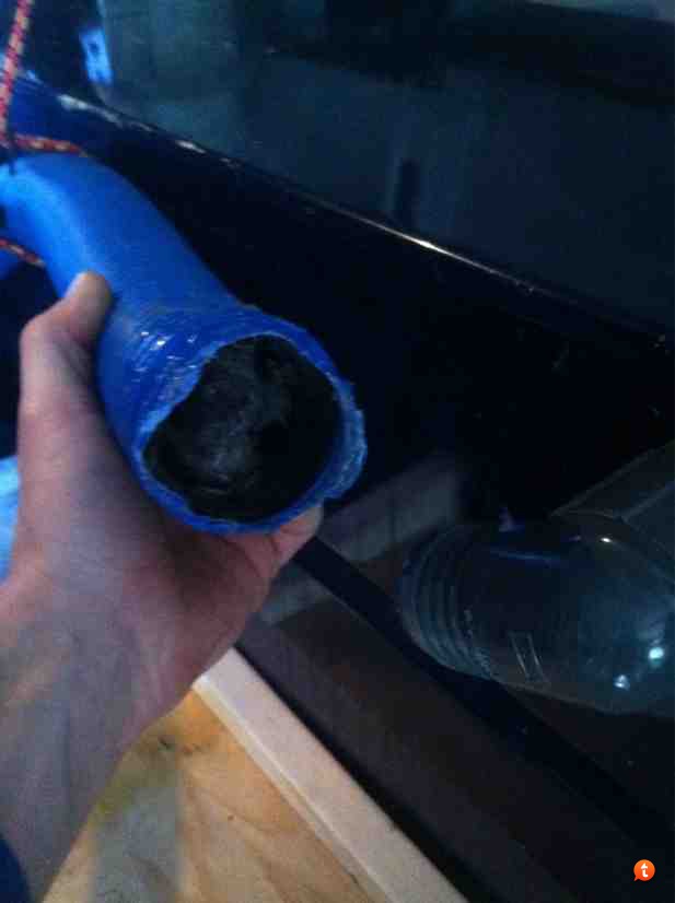

Hey wait a minute!
Last week i had this cause my high speed to act up. I even called Jim Martin about it.
Have ya checked yur hoses fur hairballs? Had a bobby pin stand up in the hose and it caused all kinds a wierdness. When i removed it I had to turn the truck back down a lil from monkeying w it.
Don furget to check all yur belt tensions.
