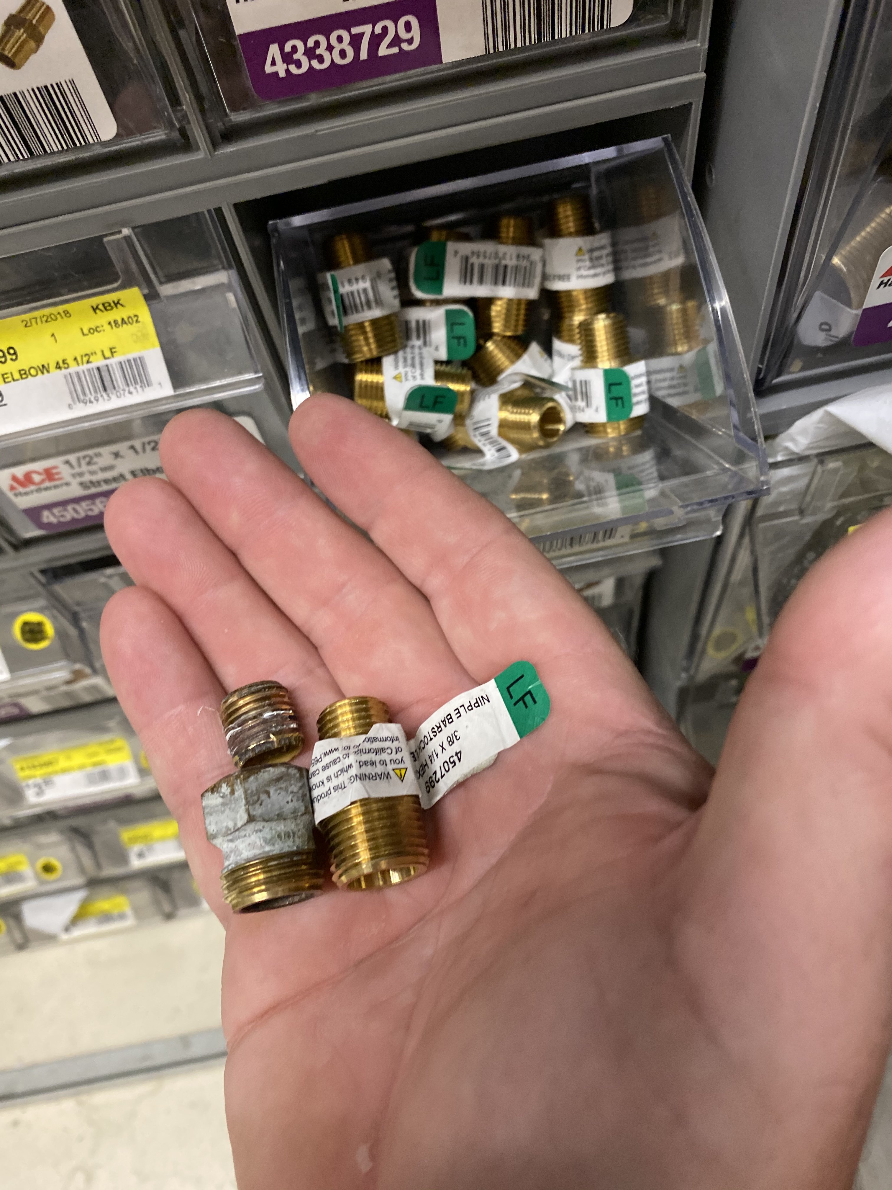

You can take the ends to ace hardware and figure out the difference. They have a board with all the firtings. You can digure out if its MIP or whatever.you can also probably get all the fittings you need to make it work.

I don't have any links for you but it should be simple. Unscrew your quick connects which are closed fittings and replace with 1/4 inch open fittings that are available at home depot or any other hardware store that sells pressure washers. They are available in both male and female.

It's NPT (national pipe thread)
Pressure washer fittings are same NPT
Common size are 1/4 and 3/8.
if your solution lines have 1/4" male ends, you need a pressure washer quick disconnects (don't know the technical name and don't feel like googling)
But you need QD set with 1/4" female NPT end
