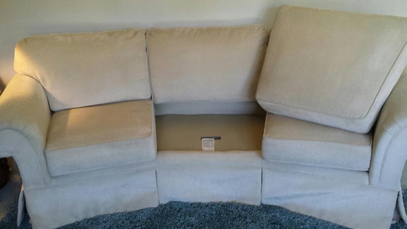

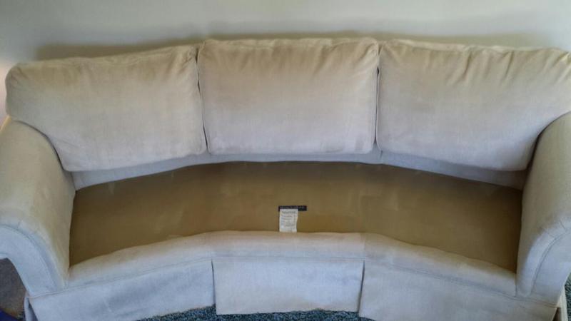

My son in law sends me pics (we think it is partial cotton) and it has been browned.

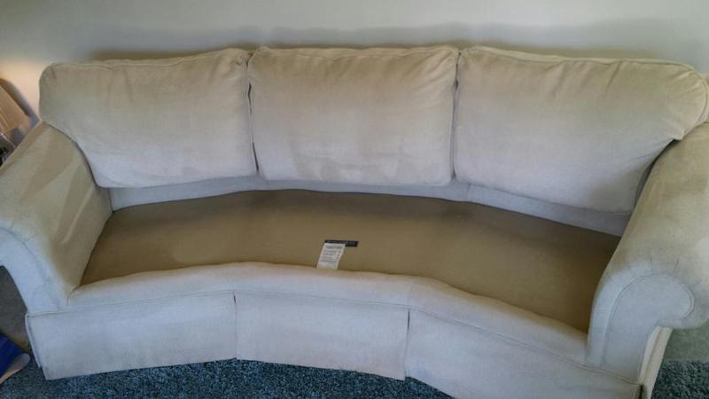

Couch is now fixed....

BEFORE WE STARTED....BIT YELLOWING IN LOWER LEFT CORNER....BAD LIGHTING IN PICS TO SEE EVERYTHING
AFTER AND DURING CLEANING PICS....WAS GROOMED OUT BETTER THAN THESE PICS ARE SHOWING

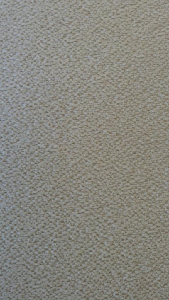

CLOSE UP OF FIBER AND INSIDE CUSHION UNZIPPED TO SEE...SON IN LAW SENT PICS WHILE WE WERE ANALYSING

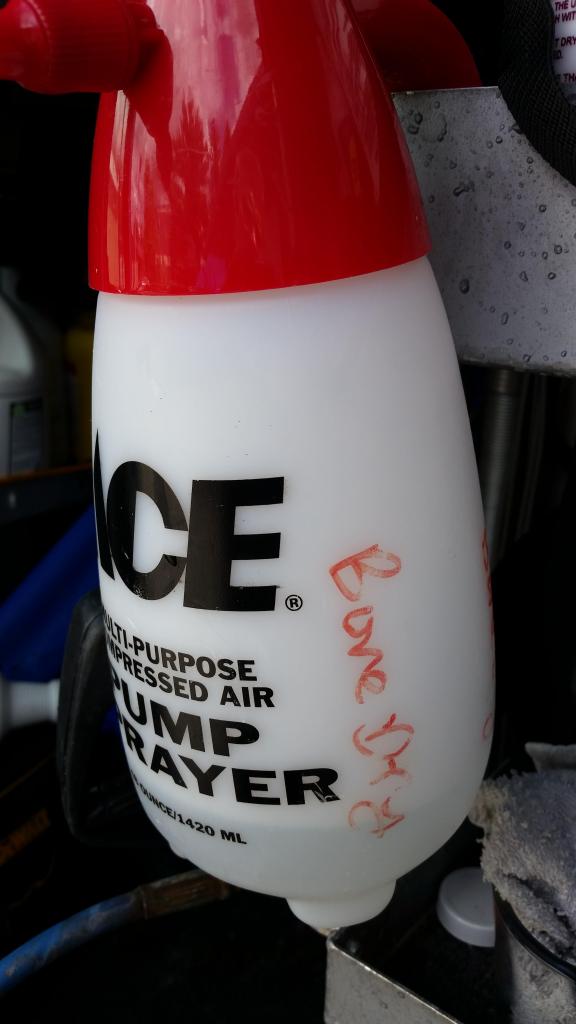

We actually were lucky enough to use an encap as a prespray we have been using for awhile (Harvard Bone Dry).....
http://hcronline.com/carpet.html
http://hcronline.com/assets/bone-dry-.pdf
http://hcronline.com/assets/bone-dry-msds.pdf

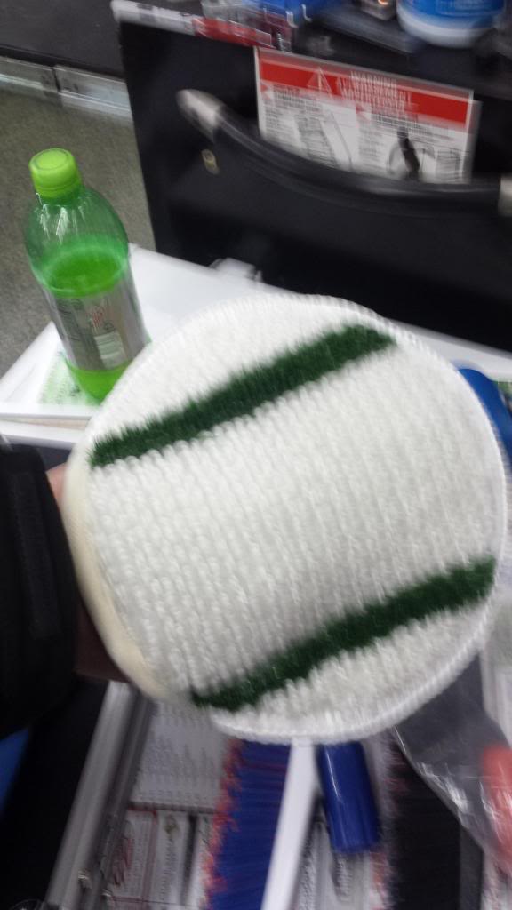

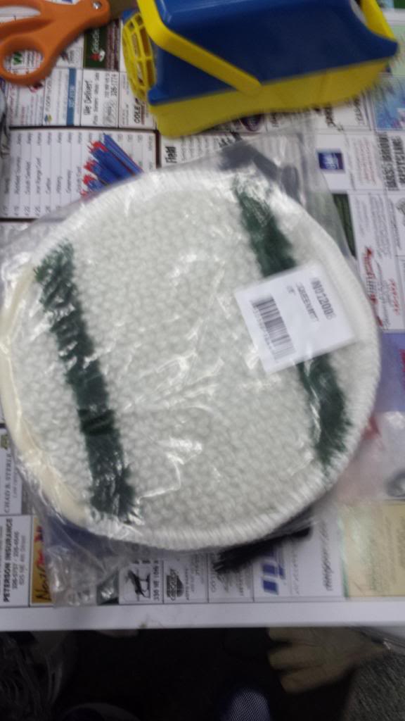

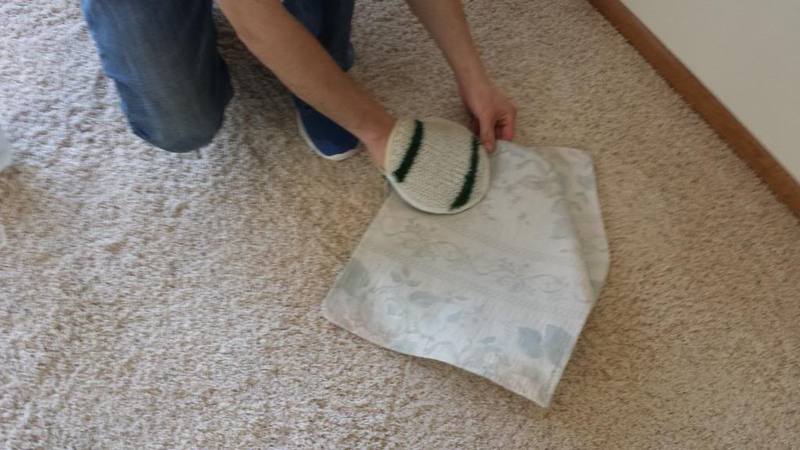

Used the Upholstery mit Scott Warrington had at MF 10 after misting on the Bone dry to agitate in the prespray...this is a different piece of upholstery in this pic....
and then did a reclean using an acid side rinse through the system (in this case Butler Upholstery Detergent)

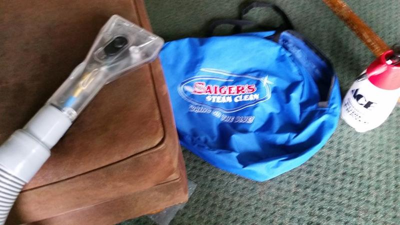

We also used the Sapphire Scientific upholstery tool which worked great and helped to make sure no over wetting and dried fast.
This is not a pic of the actual material, but a pic we took the day before on some other upholstery....and I am sure you have seen this tool....but....just showing it....

Also, my son in law let me know it was 80% cotton and 20% poly

Did that info come from the customer?
Sounds like he was reading the info off the filling tag as most manuf.
do not label the covering contents.
Reactions: Mark Saiger
11,197
Grand Rapids, MN
Actually both places in this case.
We never trust the tag as you are indicating for anything,....
Always ask where they bought it from and do they have the material content....and not the stuffing, ect....
We were able to call the local business they had the couch ordered from and confirm the fiber content.

You must of taken one of your wife's pills. The picture you uploaded of the sofa is microfiber. The arm cover is definitely a blend
gene
11,197
Grand Rapids, MN
gene
LOL....yep, the dark brown is an entirely different piece and the couch we are talking about is the first one posted.... and the arm cover is another entirely different piece as well....
Think I listed that in that post....but.....
