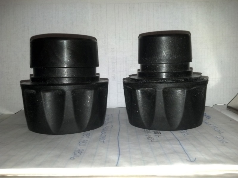

I am going to try something for the o ring problem. Mine made it through the day today but I have a idea that may solve the issue of them getting sucked away. I will let you all know if it works.
I also made some custom reducers for myself here is my 2.0 to 2.5 adapter
On my hose reel I first put a short 25 footer of 2.0 hose as I don't like coiling my 2.5 that tight and a made a cuff that goes the other way 2.0 female to a 2.5 male so I can just click the 2.5 female flash cuff and roll the 2.5 hose up

What I did was use one 2.5" Female Flash Cuff - a short 2.5" - a Cool Cuff 2.5" barb threaded reducer - 2" Male Flash Cuff. The plus I guess to mine is it can be used on any hose that comes off the reel.
How did you glue it permanently?

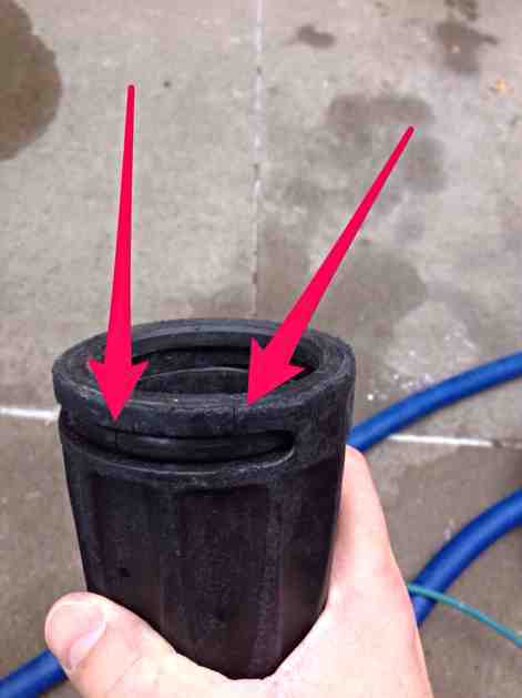

I'm still a fan but this female 2" piece has cracked in 2 places. It's been really cold here so maybe the plastic has been more brittle. I'm the only one using them so the only thing I can think is that it happened by dropping it on a concrete driveway from waist height on a very cold day. They are very easy to use but let's see how we all feel about them a year from now. Like most products, they will probably have to improve them over time. I'd recommend them but would also order a couple extra female pieces.

I found another 2" cuff that is cracked in almost the same place. At this rate, I might go through 4-6 female cuffs a year if I want to avoid using cracked ones.

Quit slamming them on the ground.
Under no circumstances will i intentionally allow one to donk on the concrete. Draggin is one thing but if you flip the hose and these dudes smack the ground especially when cold, like most plastics will break.
Bet we see a 50% reduction rate in breaks during the summer months.
