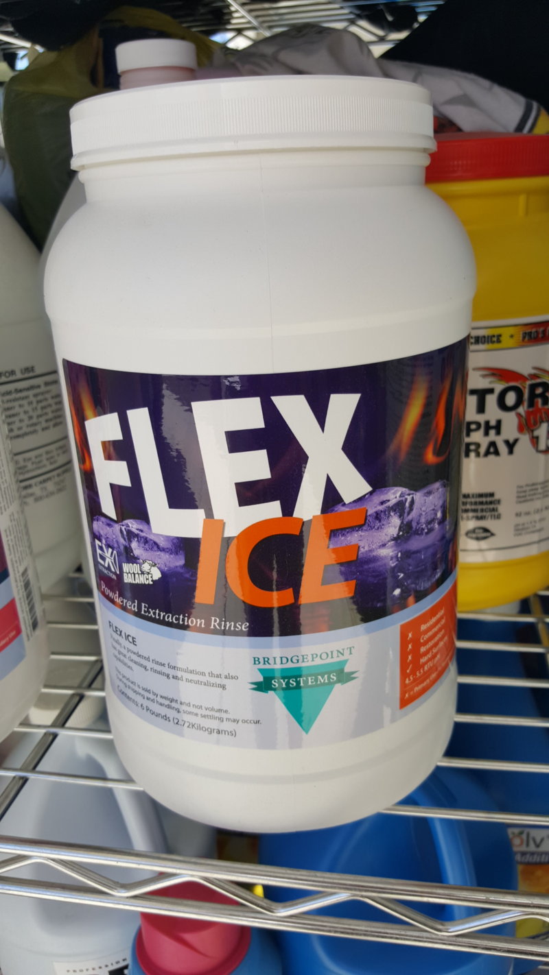

Who's still using it?
I switched from End Zone and have gone through a couple cases. Seems to work great and the new vanilla almond scent is good, but the original didn't really bother me.
Since I make all of my decisions based on board hype I need someone to tell me if I should still like this stuff.

I ran out so it's back to 105.
Mike is that the new "packaged product" blue not orange letters?
11,550
We're finishing off a few bottles usually use Procyon plus but it works good.

Yeah, I have nothing but good to say about it.
Just re-evaluating a bit as my chems are trending a bit more Harvard-ish (board hype strikes again).
Can't bring myself to totally Saiger out with that 12 pH rinse, so I think I'm gonna stick with Bridegpoint for Flex Ice, Maxim Advanced, Hydrocide, and most spotters.

Flex Ice works like a detergent more then a rinse agent.

I tried it but I don't have soft water so my filters were getting clogged in a week. If I had soft water I would switch back to it, I am not at the point of soft water yet.

The problem wasn't scale buildup on the line that was coming off. The problem was that flex ice was conditioning the water too well and the impurities were dropping out of the water and building up. It is a known problem with ice and bridge point even puts on the label to use with soft water only. But I am a man and I didn't read that part.

I like the Flex Ice rinse but after using it for a couple of months I had a few jobs where I had some spots showing up on light colored carpet after it dried. It took me a couple of weeks to realize that I had very few wick back type spots over the last few years when I had been using End Zone. I still use Ice on some jobs but my go to rinse is End Zone, it works without the callbacks.
