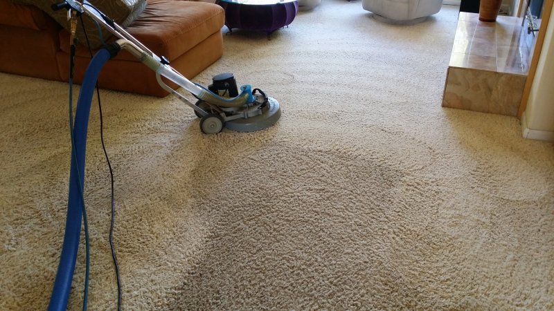

Used it as s prespray and a rinse on a rug doctor pee pee job today
Wand was so so...HOSS was crucial.

I want this stuff. My Rotovac is hungry for the taste of soiled customer carpets washed down with Flex Ice.
