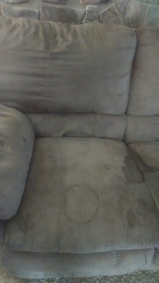

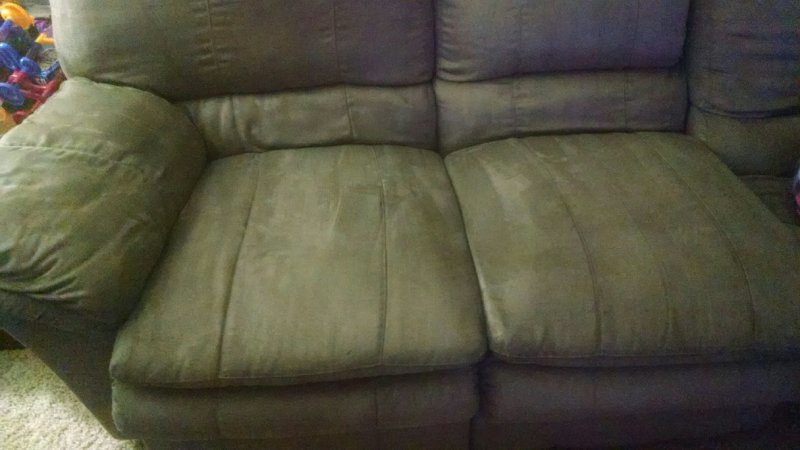

While I'm loathe to share my comparisons, since I sell Flex Ice and can't be expected to be objective, this is a test that I did myself that might be worth trying.
One of my tenants conspires with her two dogs to pollute her furnishings with a recipe that includes drink spills, dog saliva, and urine (the dogs'...I hope). I offered to clean her microfiber love seat and couch so that I could test how well Flex Ice works.
I cleaned it with Flex Ice only, and did not use any prespray. Even though microfiber cleans easily, it usually needs alkaline detergent to break the oil bonds. What I was looking for was how much oily soil it might remove without the aid of a powerful alkaline prespray.
This is what it looked like before I cleaned it:
This was the result:
To be clear, I don't think I'd have gotten results as good if the fabric had been "shiny black" with oil, as many microfibers are when we get asked to clean them.
I did feel, however, that the results proved that Flex Ice does clean, and is not just another rinse agent.

Jim in your pics. The loveseat is dirty and you show a cleaned couch. Also the color change, because of it being wet.
I just saw what I did. I test products better than I post pictures it seems.
When I have some time I'll get those fixed.
In the meantime, yes the "after" pics are wet. I should have taken dry ones, but I was already in that place too long. Had I stayed much longer I would have wanted to evict her and her dogs with her.
