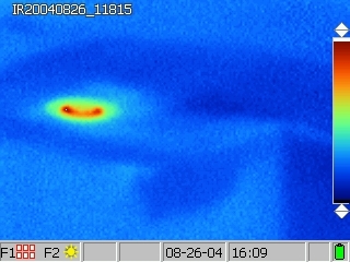

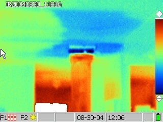

can you share any pictures of what you can see with it?

so you can definitely see the water in or behind the walls?
Yes...and no.
You see temperature differential so wet areas show up as cooler which leads you to investigate further with a non destructive moisture meter or penetrating probes. The same when you are doing a final walk through for dryness. You check anything that might show up as still blue.
It works great you find tricky spots that might have gotten overlooked. It is also a time saver.
It can be fooled by cooler air voids, metal flashing so you never want to solely trust in until you have verified it somewhere on the jobs site with other meters.
