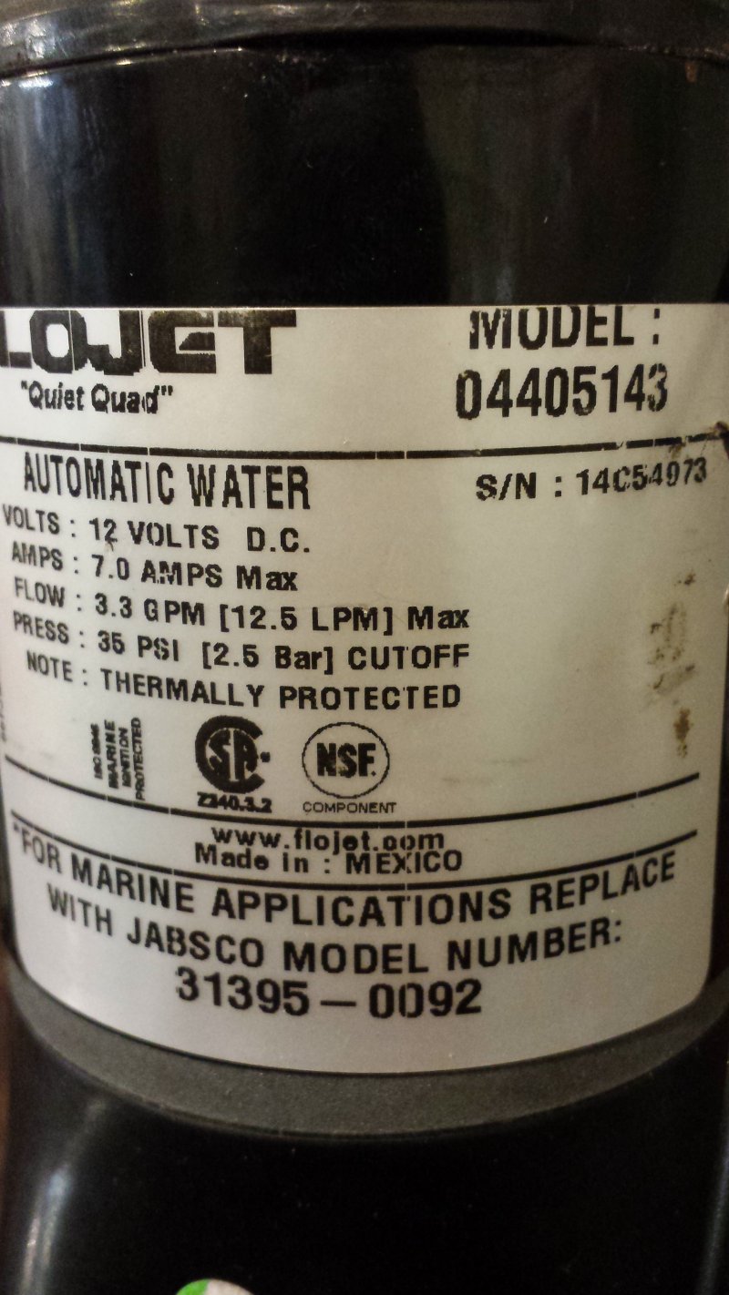

I have been having problems with my pump over heating it says:
So I took out my accumulator tank and it still over heats.. Is it just the wrong pump for the prochem water box or what is going on here? It's OK for a while but it I have bigger jobs it shuts off due to high temps..

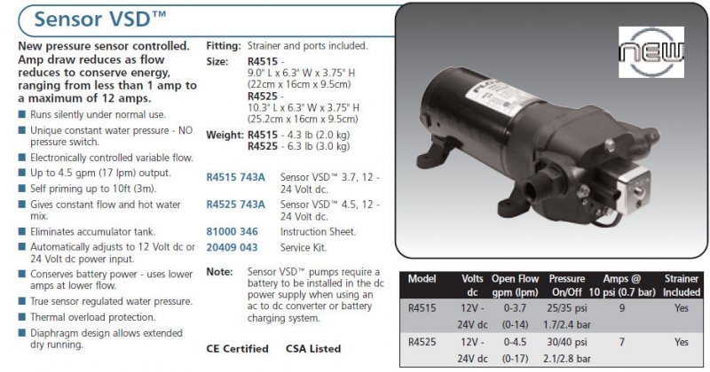

I imagine your water box valve cycles the pump often enough to overheat it on long jobs. The pressure switch is rated for only so many cycles as well. You might consider one of the newer VSD pumps. They use a pressure sensor and variable speed instead of a pressure switch. The Flojet R4515 743A is a good match to your specs:

I never had pump problems before this.. I think I just bought the wrong pump.
I agree with you Gene, I think it has to due to the toilet type valve that leaks when you use any water... It needs to shut off and have some time before it starts up again. I think it runs non stop when we are cleaning. .
