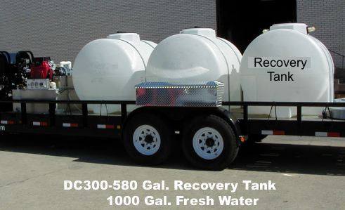

Ron;
I have a TM that can supply your "hi-flow" water requirements:
Larry
