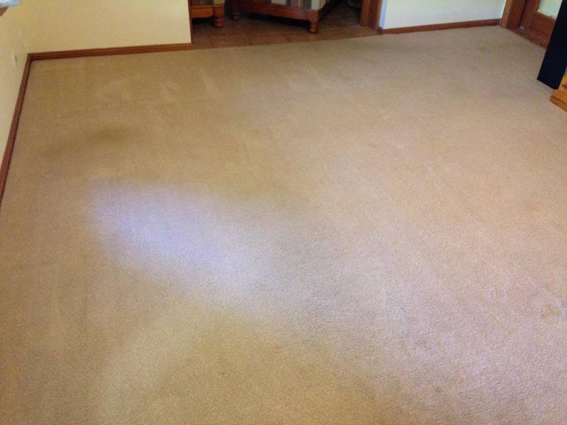

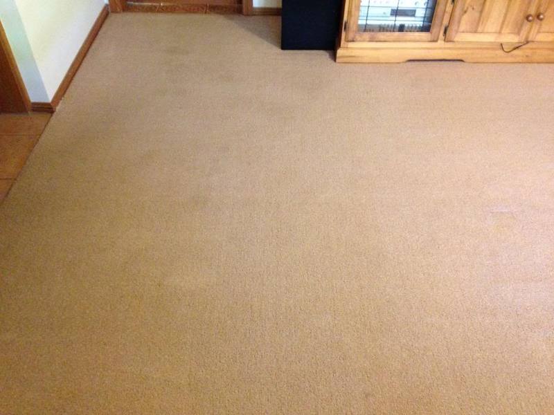

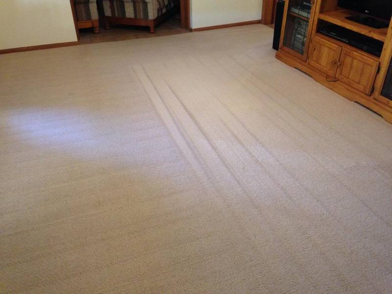

I like to have a really good look at various methods and then think outside the box a bit and combine them where possible to come up with a better solution and result overall than if I just settled on one process by itself. I don't mind spending the time I just want to be paid to do good work.
So if HWE was out altogether I'd use a 175 with encap brush and shower feed to foam encap the carpet and break the soil bonds. I'd then Put the pad driver on and dry / extract with a bonnet - changing it VERY, VERY frequently. Then groom it with some drum brush device, Kirby fluffier, Sebo Duo / P or CRB.
I currently use a 715 with shower feed and encap brush to apply my encapsulating pre-spray and then I rinse the crap out with my plastic toy extractor.
I did this job a little while back and made some videos and took some pics. This is a basically where I'm at.
http://youtu.be/SOcBRw_VER4
All extracted with the Bissell Big Green.
Mardie. You offered me some good advice a while back, may I return the favour?
Go buy a $500 Bissell Big Green and try it out on your next nasty job after to use your VS machine. I'm confident you will be even more impressed by your end results than you already (and justifiably) are.

The vision thing is a bit of a bummer. You know though, I honestly think I'd pre agitate all my jobs irrespective. Just my preference though. Thanks for the kudos GCCLee

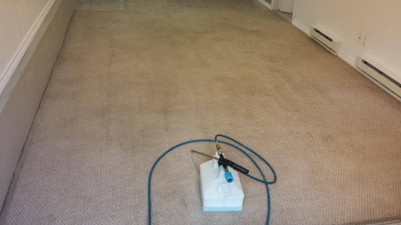

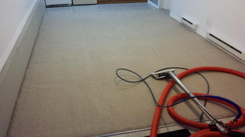

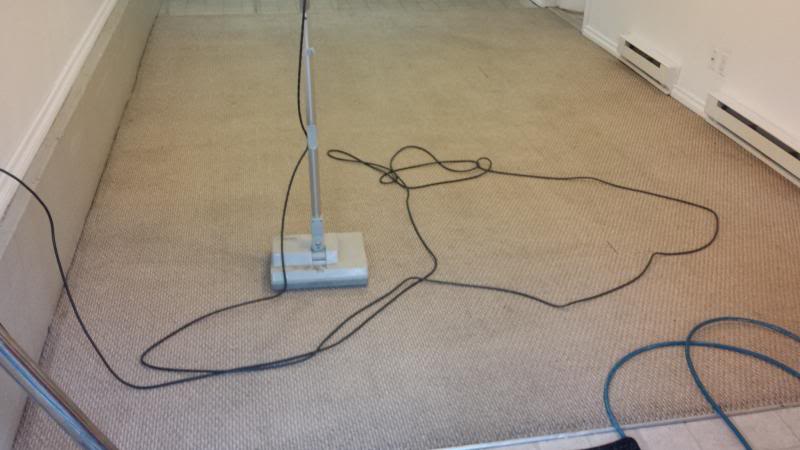

You do REALLY good work Grant!!
I know how you guys feel. Someone once said, if you haven't got the time to go back for a redo. you haven't got time to do it wrong.
So if I couldn't HWE, either by truck or portable, I would test the methods. I would probably end up using at least two, one method as scrub and the other as the "rinse". Maybe a prespray with HOST. Or prespray and scrub with a CRB or 175/OP/trinity and then pad. Of course, My CLeartrak would still be the first equipment off the truck.
But as long as HWE is available, I do like how it flushes out the carpet:
These stairs were well vacuumed yet still the water was brown as it flushed .
And I do like the results on the nasties. I'm like Grant, spent at least 2 full hours on two rooms that had been Rug Dr'd almost to death. Don't know how those d,,m things got a SOA.
I didn't take a pic of all the sand and shtuff that I wernered out of it.
So Mardie, I suppose you see the carpets from other HWE cleaners that look like the first or 2nd picture. I suppose customers wouldn't have to call you if the cleaners were getting it like the last pic.
