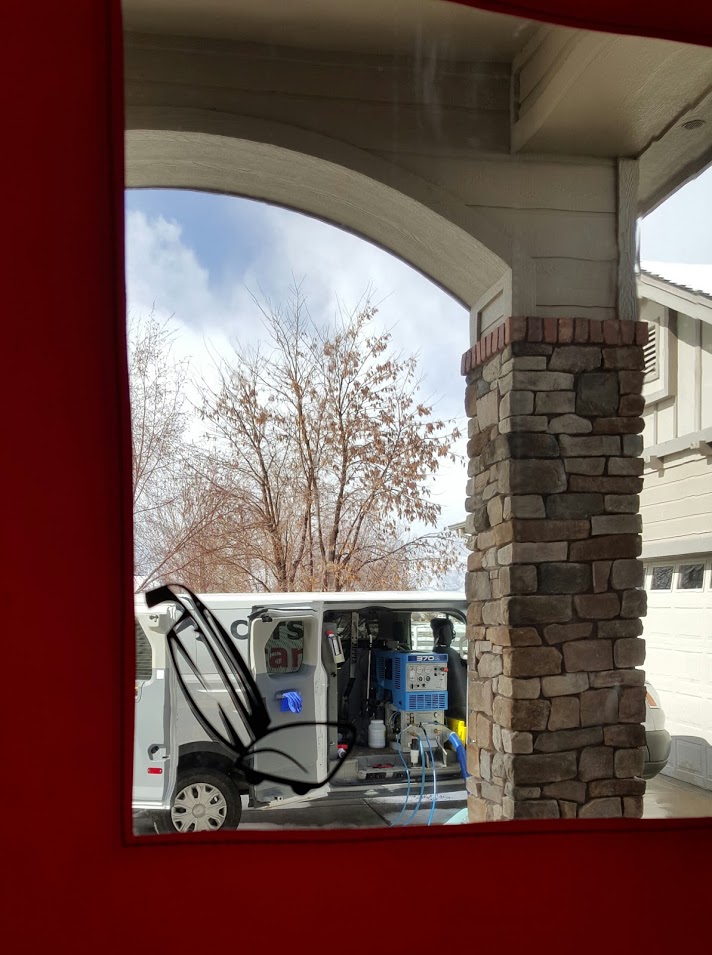

For such a tall dork, I've always had decent balance..
117,366
but never as well balanced as my current cleaning rig..
4LZEBOtxOm849TUr_n3Ob3sJXSNxXFKI6JBjC76p22sxuvvLWEJEKZSty87DIMGxfWE3lkIWtyeWXrQZJMP=w713-h955-no.jpg
Seriously... For residential suburb work where most jobs are well under 200 feet, my system can't be beat.
The world's best selling truckmount, 370
A all metal Royal Vacuum for deep digging action
Royal/Dirt Devil for upholstery and stair vac
Still looking for a way to edge, the Pro Team is about worthless.
Moderate soil gets the 10" Brush Pro and a Mach 12 rinse
Neglected carpet gets the 360i and edge and a final groom dry pass with the Mach 12...
I'm using lots of Procyon and water only rinse. Almost all my jobs have been young families with young kids and babies on the carpet.
Omni and Dripods are delivering GREAT dry times. No/Low humidity helps the whole picture.
Good amount of tile too.
PMF Hard Surface wand is seeing lots of action, more so than the Turbo Hybrid. People are not that filthy here, thank gawd.
and yes a 15 foot whip hose connected to how ever much 2" I need to reach my 50' of 2.5.
300PSI on most everything, 4 flow wand, 9 flow RV.
Not high production but for establishing myself as The Premium Cleaning Service in town, it kicks ass.
and the word is spreading fast.

Seems you got it dialed in. I don't see the Z word.
28,280
Nice looking unit, leaves lots of room in the van. I use a lot of Procyon also but instead of rinsing with water, I make a slurry of Procyon plus powder. 32oz to 5 gal headpack and meter at about 2-4gals per hour. I find it cleans a little more efficiently and still doesn't leave any appreciable residue. Otherwise, I have to represpray certain areas. What temps do you average at 150ft?
Reactions: Mike Pailliotet
117,366
220 or so
If I'm "just" wanding then yeah, I use a rinse agent many times. The brush head RV just kicks ass. No streaking, no post spotting unless I spazz and miss a spot.
28,280
Pretty powerful machine for it's size. I can't see needing more than that for residential and light commercial.
14,644
Are you serious with using only 4flow on your mach12 wand? I don't see how you enjoy cleaning if your flow is that low. I had that on my mach 12 for about 4months before I got to my senses and upped it a little bit.
11,567
Considering the wand is for a post groom mostly And Mikes already rotovaced it 4 flows fine.

220 or so
With 4 flow in the summer you will have scorching heat in Nevada with your 370
I am running the Mach 15 with mine. 7.5 flow 300-400 PSI.
I 'm around 180 with mine ATM (Idaho in the winter) but it builds up to 225 fast once it's heated up and doing it's thing

Love the set up !!
I was considering a Pro Team upright .. I heard it was the Lux knock off .. which I love my Lux Commercial
Have you had any issues with the exhaust seeping into the house when aimed at the front door? I use a rubber mechanics hose to steer the flow away.
4 flow on a 2 jet? Is there a 4 flow 4 jet out there?

You shouldn't go through the floor on the Unibody Transit.
The Speedy Sweep version of the Proteam is not a digger or a groomer. I don't know if it's really any different than
