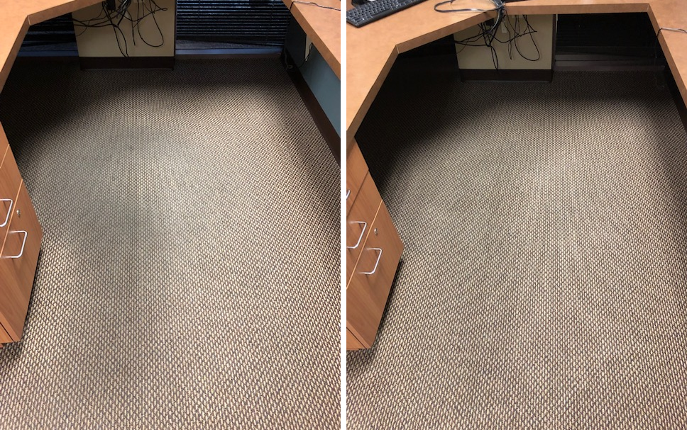

I talked to a cleaner who has a janitorial business.
One of his accounts is MMI - Motorcycle Mechanic Institute.
I asked how he would clean the transmission stain out.
He said he would test an area using oven cleaner.

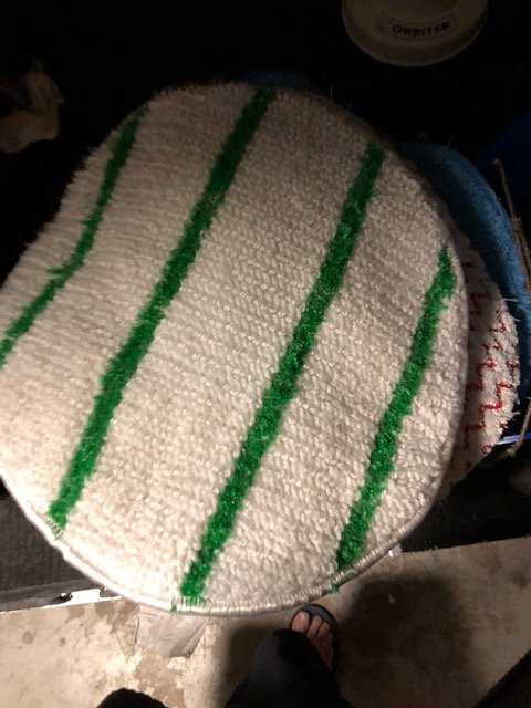

He said does on CGD, and it works. He said he would soak a bonnet (picture to follow) and hit it with that.
I bought one of those pads and tested it on a dirty carpet job I did.
I don't know about the tranny fluid that demo is on the 5th of July, but I love what that soaked pad did.
It was quick, not the five minutes hitting the area.
Followed with a microfiber to pick up.
To make things even better, when I washed the pad, it came out like new (whaaat).
The carpet in picture wasn't completely dry, so it hasn't lightened up completely.
