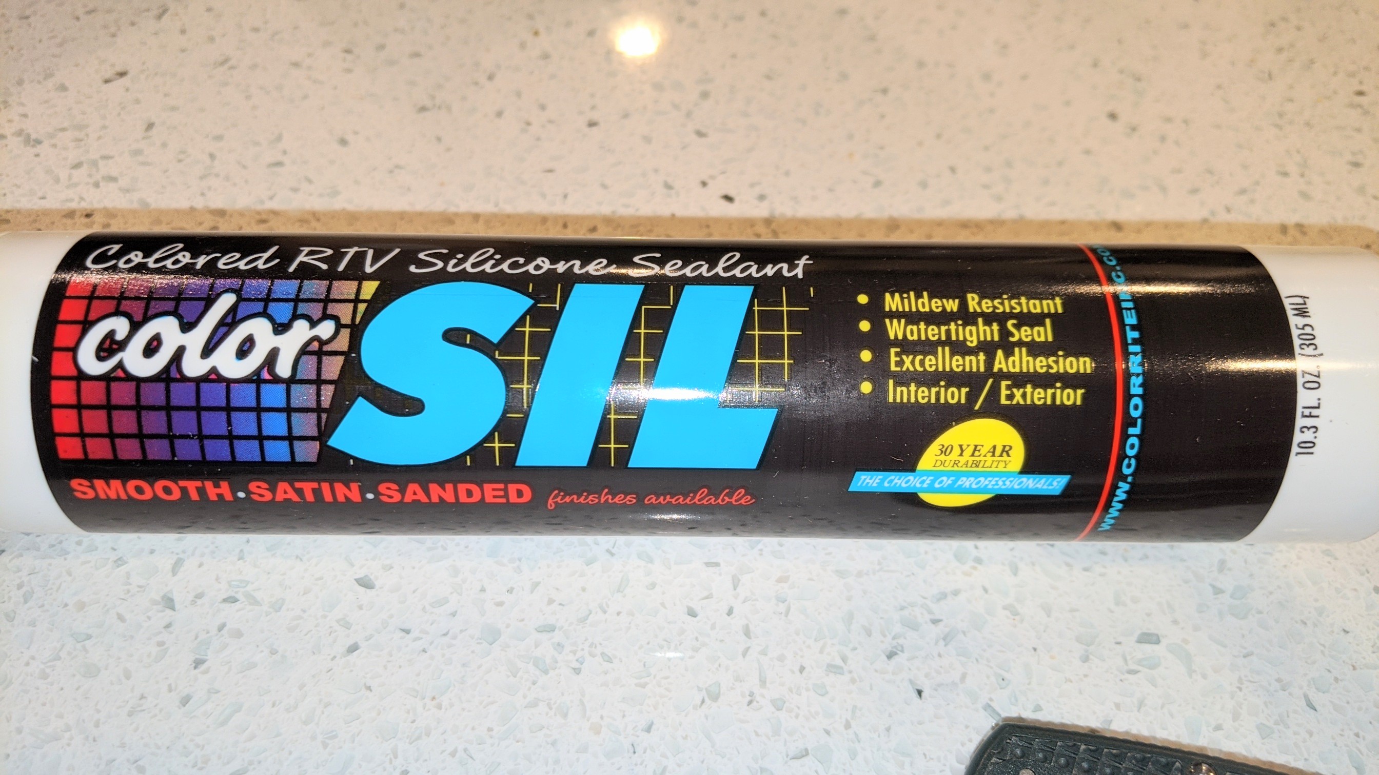

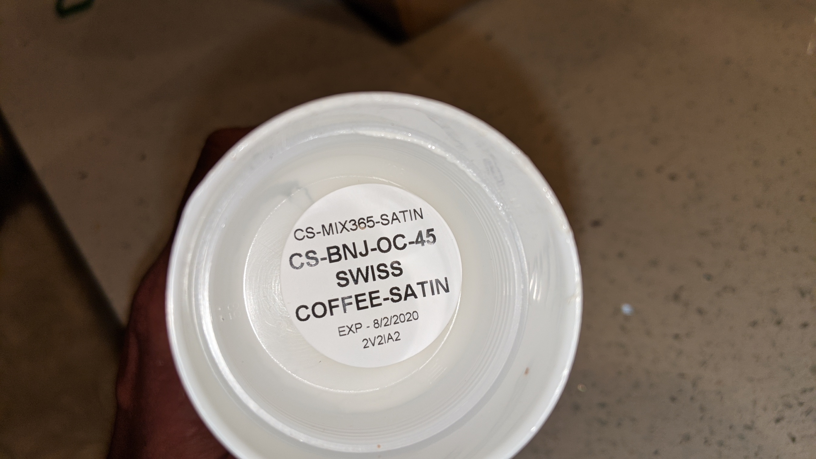

I think it was Bill on here who 1st turned me on to this stuff.
By far the highest quality, easiest to apply silicone "caulking" available.
RTV and available in three textures/ finishes and most importantly, available in every grout color and Benjamin Moore and Sherwin Williams paint hues.
It's pricey but pass the cost along ($30ish a tube)
I watched two painters caulk, mask and paint the gap under some baseboards yesterday. Hours of work for a shitty end result. This product is a no brainier

Do you buy this at Benjamin Moore and Sherwin Williams stores?
116,329
Only available here
saved in labor
sh1tty work comes in all professions
Good caulking requires a "touch" that many (MOST) don't have
but a couple questions from a "Handyman", Big Slim
why the need for 100% RTV silicone on any molding?
and what happens if Mrs Phiff want's a new paint color in a few years?
You tearing it out?.....cause paint won't stick to RTV silicone.
the next "handyman" that's hired to paint the molding will be cussing the "professional" gOOber that smeared non paintable gOOp on any paintable surface
oh yeah, here's a "handyman" tip.....and don't smear much goop on the molding while wiping/fingering smooth regardless of the color match....cause there's a strong likelihood the sheen won't match and will be noticeable in certain lighting
