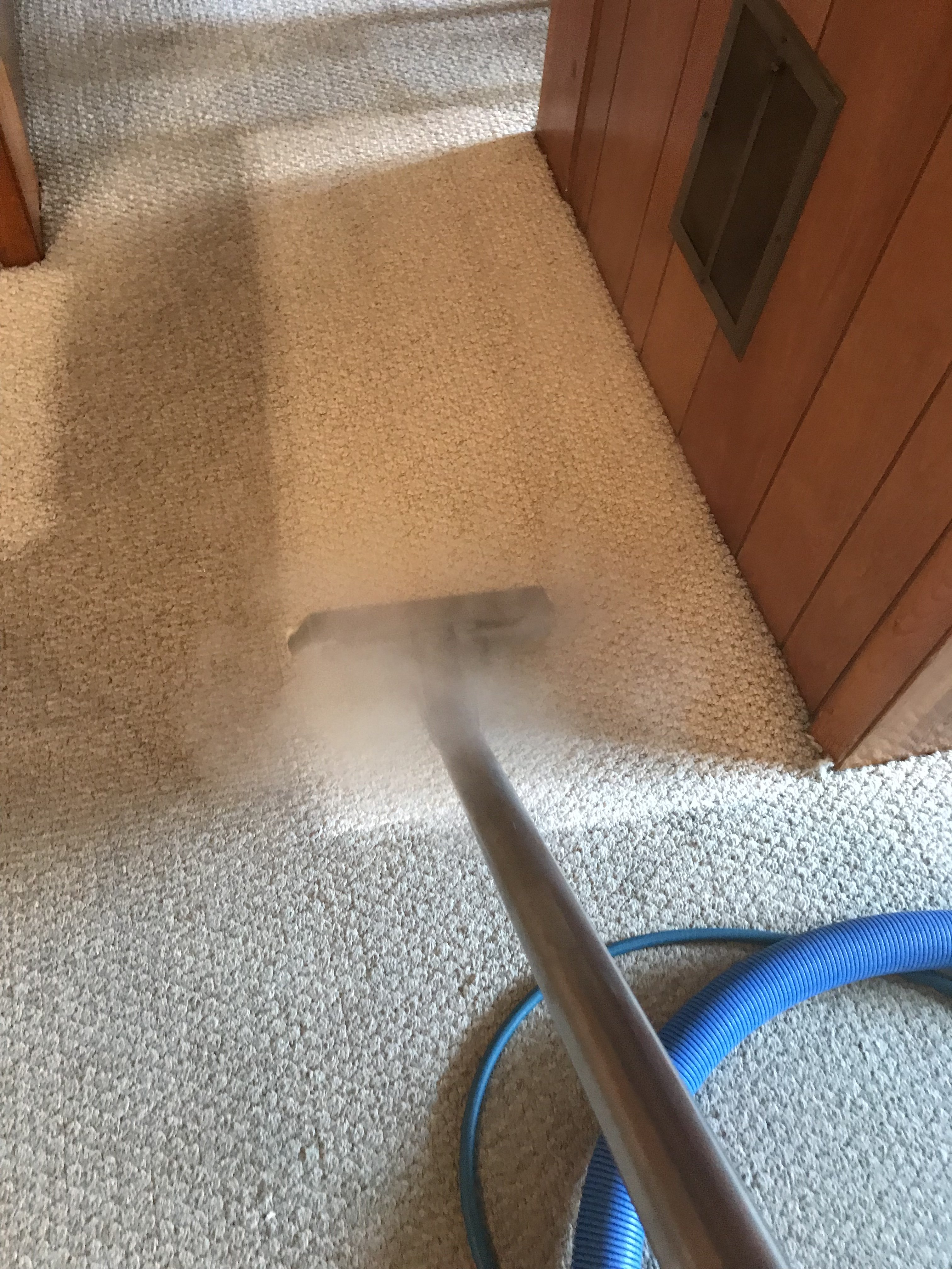

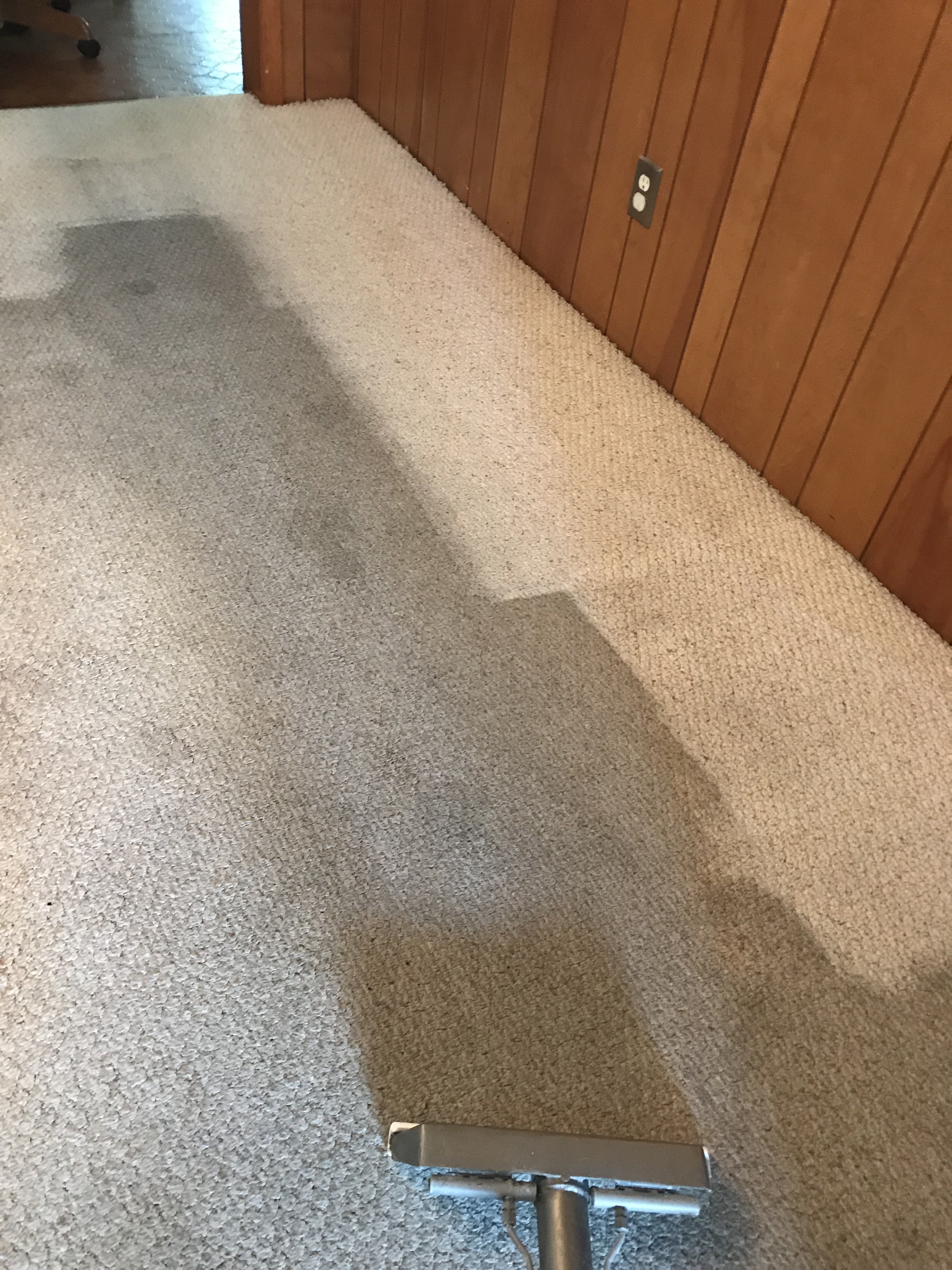

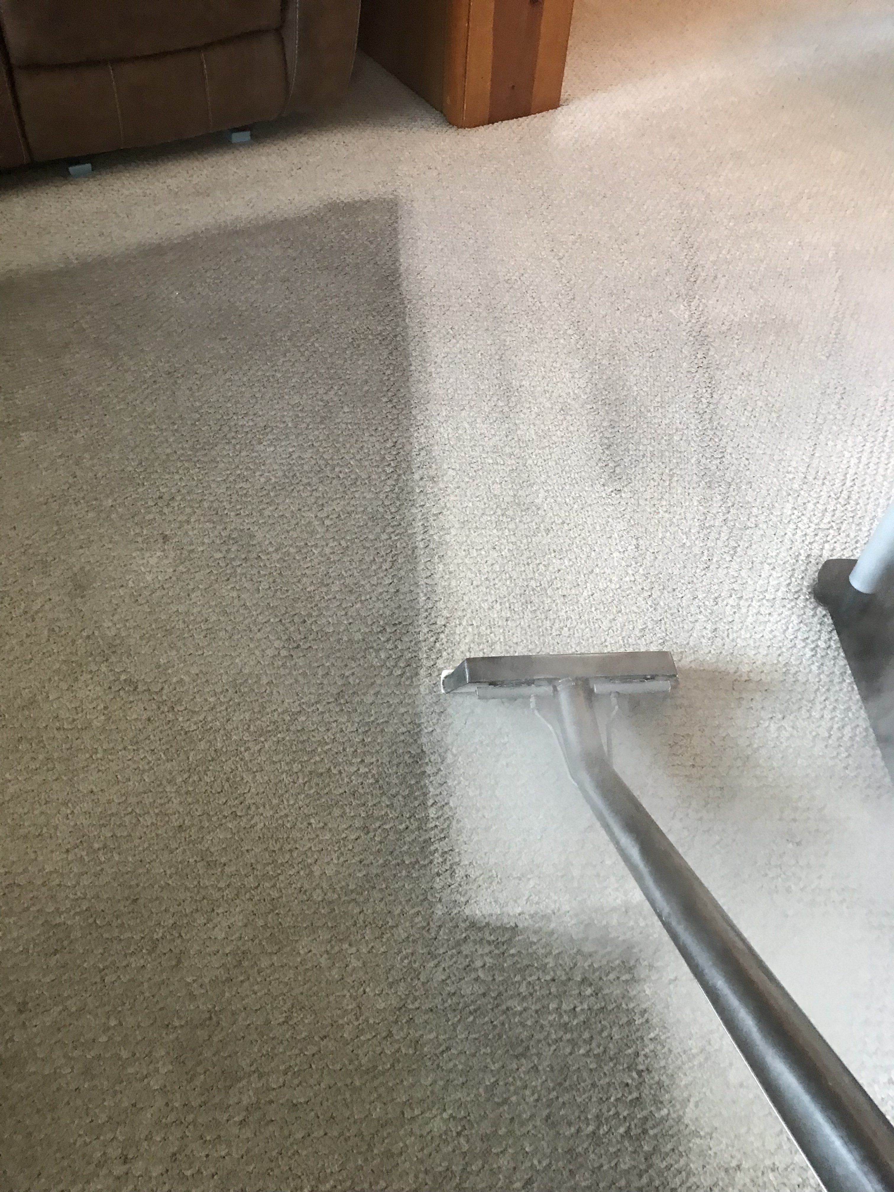

I hate to be a Boyle, but you have overspray issues.
And a blocked slot
I actually like the overspray on the edges of the wand, it cleans better against the wall. The TI wand has a bit of a gap where the tub comes through between the two manifolds. This was one pass, needed to take second pass and dry stroke to get the finished look;)
26,930
You’re fooling yourself buddy. You’re staining carpet under furniture edges all over town.
Idiot
Overspray or not, if you're cleaning right up to the furniture and not blocking or tabbing it, it will wick under and stain. Either stay a couple inches away or block or tab it.
