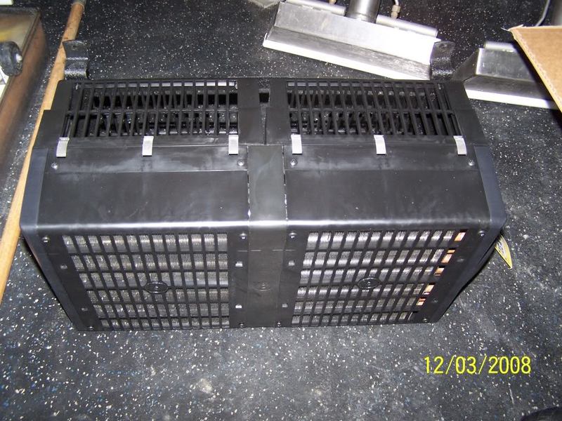

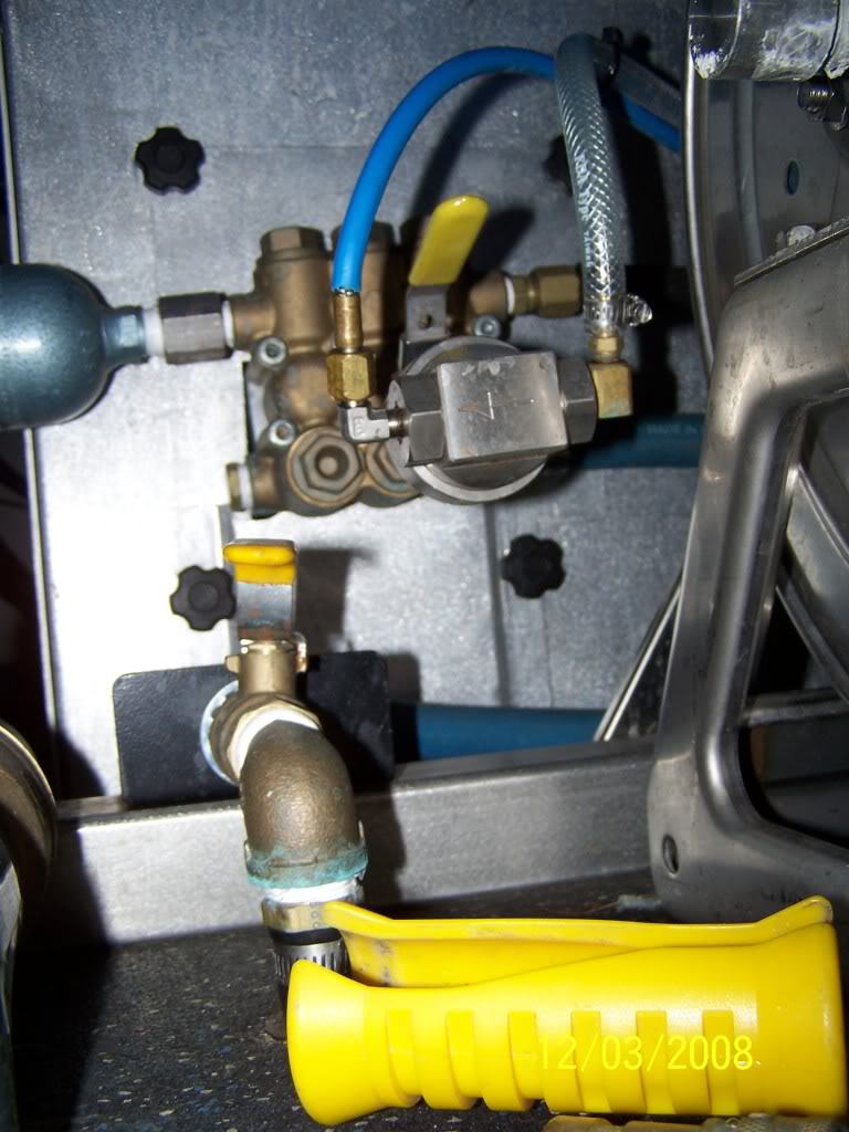

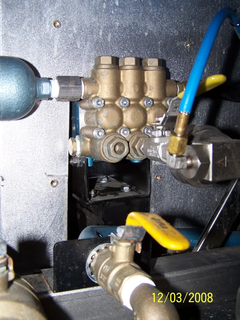

Here are the pictures of the heater and a cover I had made for the pump. I am going to install the heater over the weekend. I will post pictures when I am done. I think I might try to run a loop of radiator hose from the heater return around the head on the pump.

We sell the 65,000 BTU heaters with many Vs. It keeps the box really warm when driving down the road.
