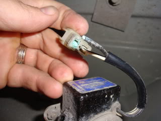

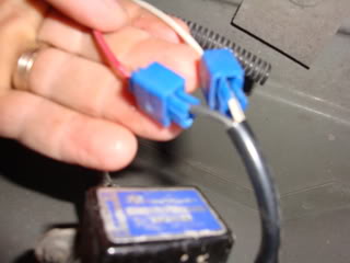

So it was a corroded ground wire at the fuel pump.
I barely touched it and it just separated.
Took me longer to find these nifty blue connectors at the auto parts store, than it did to do the repair in the parking lot.

If the wire is exposed to the eliments I would solder the wires together, and heat shrink tube them so moisture can't get to it.. That will last 10 times longer then any connector.
B
breathe72
Done deal. Thanks!
