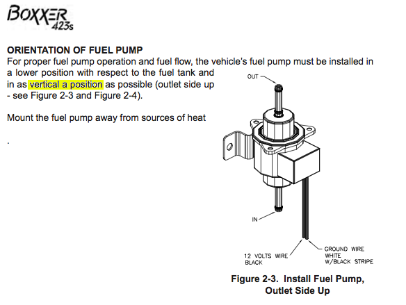

5,856
Shawn Forsythe
That is great advice with mounting it under the van on the frame.. make sure that it is mounted horizontal and not vertical too.
Brent, not true about the orientation. Some fuel pumps absolutely MUST be mounted vertically in order to function properly. The pumps that Hydramaster uses, and many Prochems use must be mounted nearly or completely vertically or they WILL fail. By "fail", I mean you will damage the fuel pump, rendering it inoperable. That is not to say the model Louis is using will have that problem, but it is a concern that should be addressed by heeding the mounting directions specific to the fuel pump.
