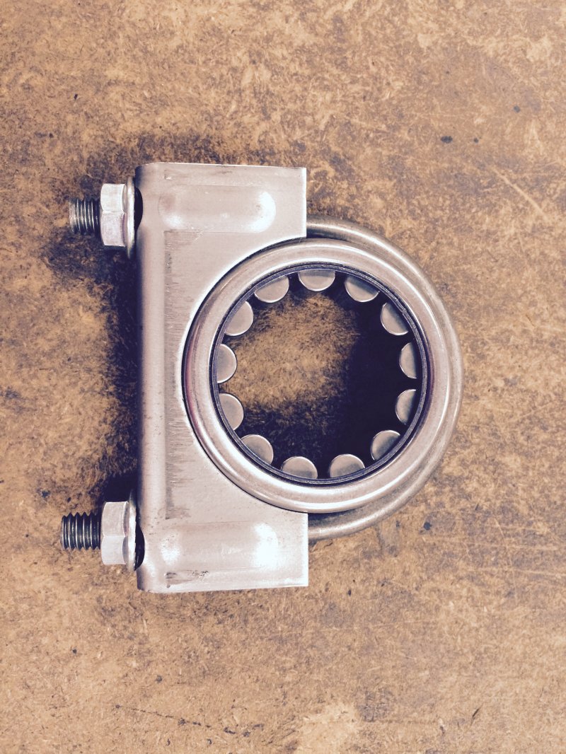

forgot to mention, while I was under the van working I also decided to change out the muffler bearing. Have you ever had one of these fail?
