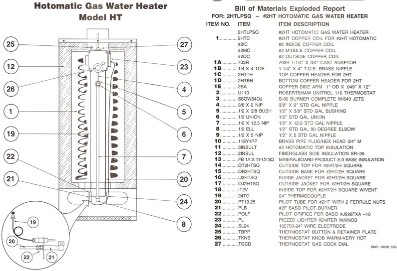

I'm not positive on this so maybe give Judson/Cobb/Little Giant a ring
but

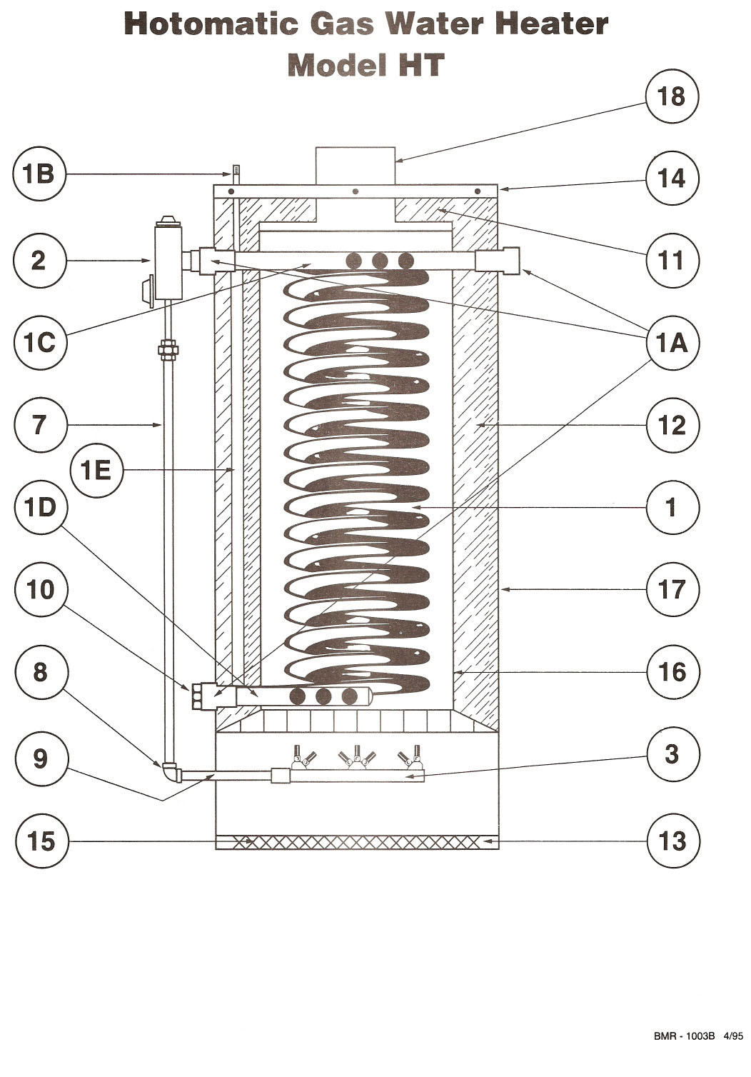

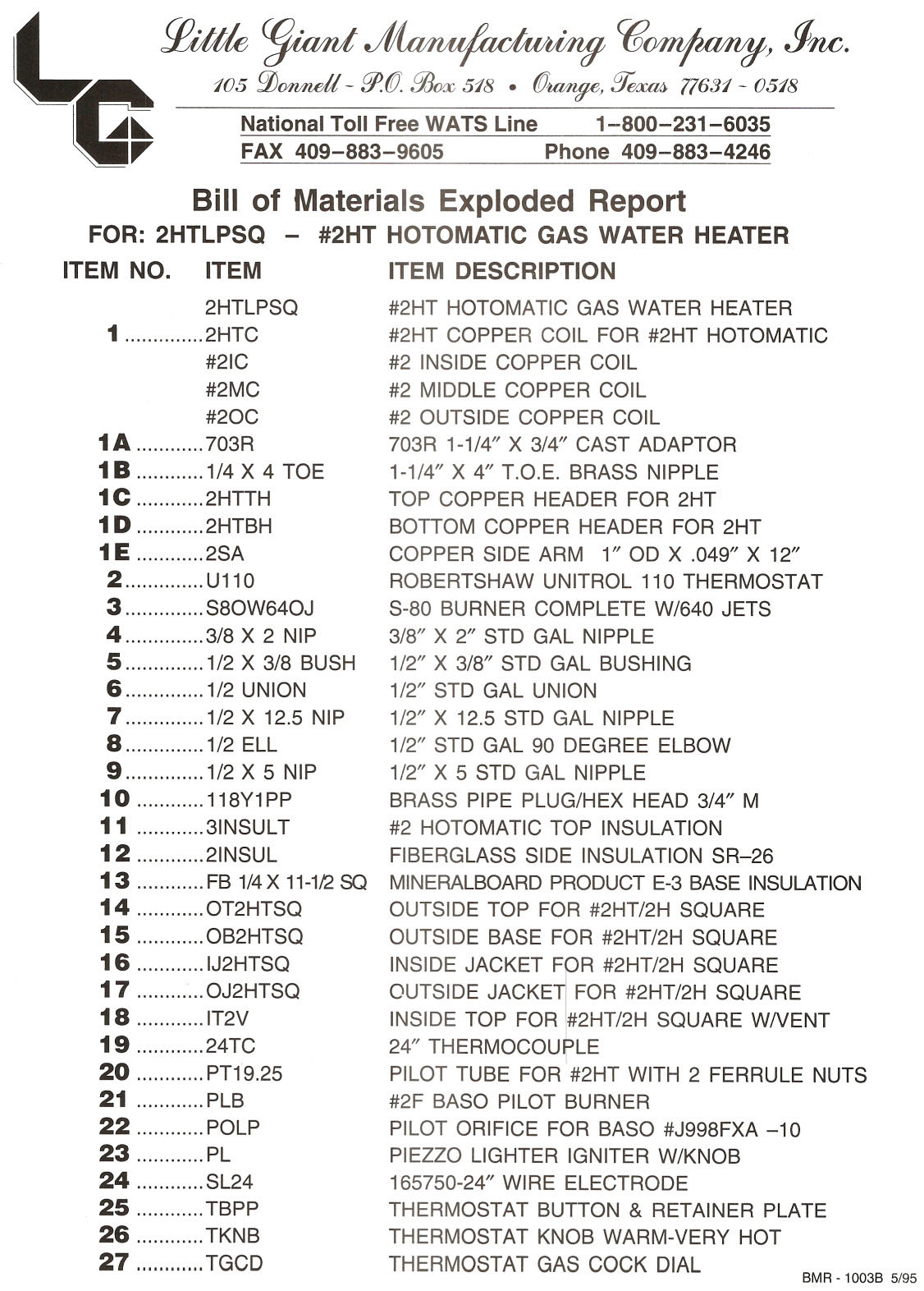

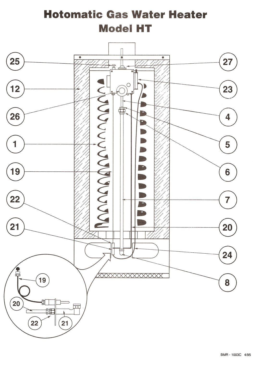

The parts diagram list the 2ht as having #640 burner jets...which also get listed as 64
Cobb as well as many other places, like restaurant stores, have them listed for sale
