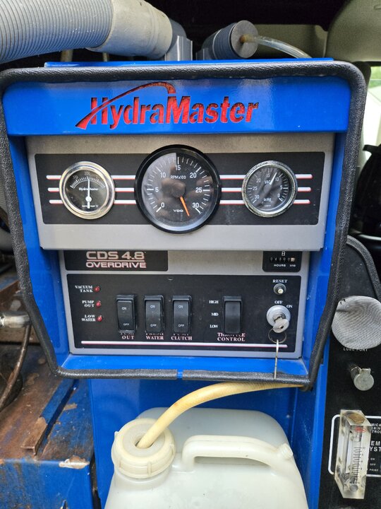

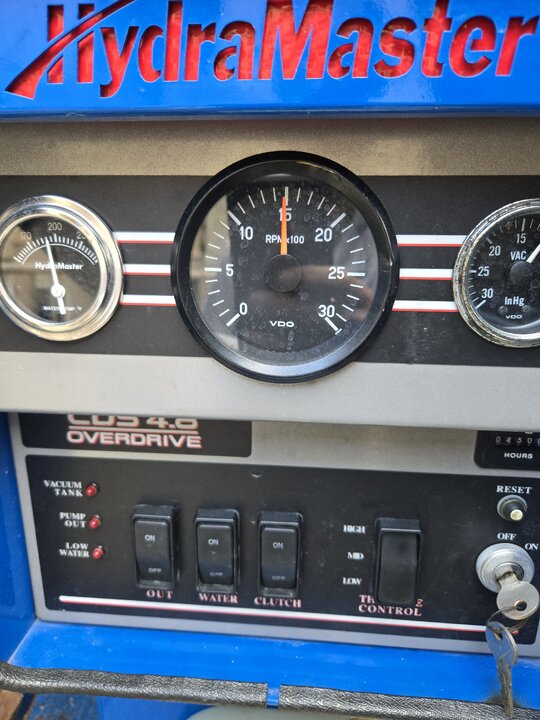

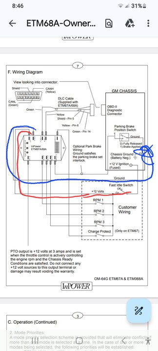

I found a broken ground wire early this morning and fixed it before we got on the road. The tm ran fine for our whole job this morning, whereas it has been getting worse all week. Hopefully that was the culprit! I am going to change the engine oil and clean the MAF sensor this evening, I just picked up some MAF sensor cleaner. I'll hold off on doing anything else until I see how it runs on Monday. I'd prefer to not throw any more time and parts at it right now. But I will if the problem persists.

I discovered a broken ground wire to the throttle controller this morning and fixed it before we got on the road. The machine ran fine for a few hours this morning with zero interruptions, hopefully it is good for now. I'll see on Monday when we have our next jobs. If we get through each of them without a shut down then I'll consider it fixed 🙏. Maybe then I'll get at least a few weeks of solid use before the next trial 😄

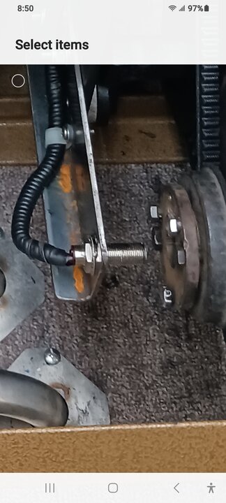

Was the wire connected to a dedicated body ground or just screwed into the sheet metal? If it was did you connect up to a proper ground?
I read you say that before and sure enough it was connected to sheet metal. I had little time before we hit the road so I just reconnected it where it already was for now. Not sure where proper ground is and was going to read about it tonight. I suppose any factory accessory ground wire would run back to proper vehicle ground, so maybe I can just look for one of those and follow it.
Curious though, I've seen some factory ground wires running off the battery directly to the sheet metal in the engine compartment. If the sheet metal is bare, why wouldn't it make proper ground?

If you remove the side plastic panel along side your park brake pedal youll find a proper body ground. Theres probably several more under the dashboard but i know where that one is. What your looking for when looking for a proper body ground is manufacturers wires already grounded to a bolt not a screw most likely 10mm socket required

The sheet metal can and will make a good ground if done properly. Heavy emphasis on properly sheet metal screw doesn't qualify . When you find a manufacturer ground youll find a threded bolt not a screw and will have a nut welded on the backing so the ground gets a good solid connection sheet metal screws are notorious for vibrating loose and causing interrupted connection and possible damage to sensitive Electronics ( like a throttle controller ) heres another thought. Now that youve found and positively identified a problem with the controllers wiring, is your old controller really defective?
Great tips Dwain. It helps me to understand why something should be done. Knowing the sheet metal just doesn't hold typical screws very well over time with vibration makes a lot of sense. I'll do it right.

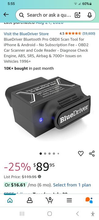

Do you have an engine analyzer? If so does it show live data? If not i recommend one of these blue drivers i have 3 (1 in each vehicle) their inexpensive because the expensive part of an analyzer is the computer and screen this uses the computing power and screen of your phone. you already own the expensive part. Anyway you need to see the live data for the o2 sensors on the lean bank you may not even have a vacuum leak. My 08 ranger had lean codes for bank 1 turned out to be catalytic converter
Thanks for the recommendation Dwain. I'll grab one of those. I'll be doing more and more of my own eepair work for now so it will certainly prove handy. I imagine the money and time it saves me in not throwing too many random parts at it will be more than worthwhile. Thanks man!

For an all around analyzer you can't beat the blue driver there's cheaper imitations but they don't have great customer support or lifetime free software updates. The only criticism I have is that it doesn't do transmission temperature which is what I require for changing the transmission fluid in my new Toyota. For that ill invest in another analyzer for the shop . If you're like me and carry iton the truck. I highly recommend that you popthe extra for a carrying case you won't be sorry
