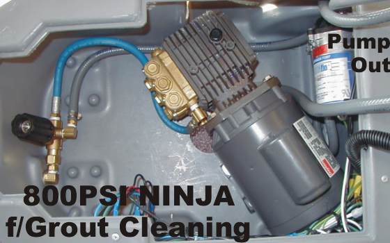

This pump is a 2.2 GPM model:
Larry

Willy P
And that my friends, is a kick ass pump for your portable. I used 2 of them - over a 10 year period and the second one was still running fine when my van got torched. Downside is the amp draw, but the performance is worth the plug search. I had that and quad 2 stages., 2 sets in series to a paralell. To quote the late Jim Darling of Chemspec, "It would suck dust of the moon".:D
