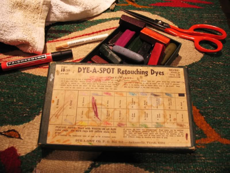

Had an opportunity to use these today. The kit is from the fifties.
