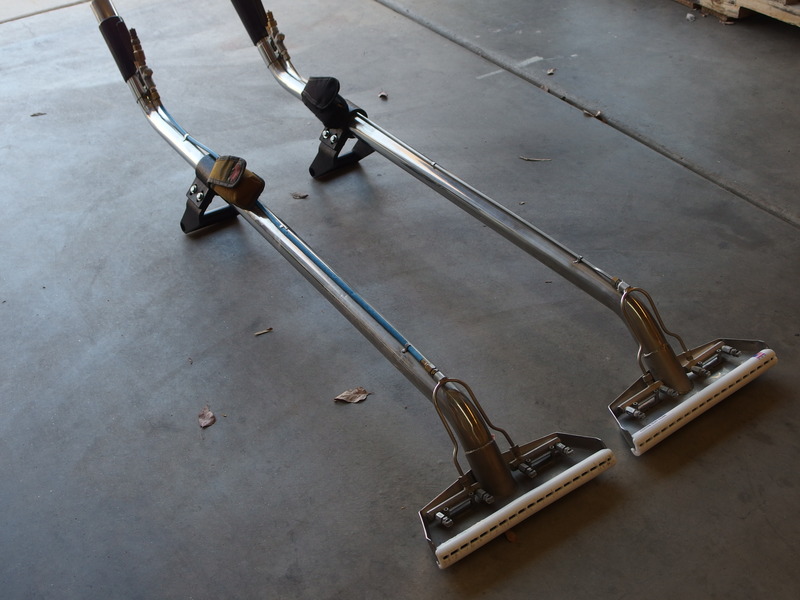

absolute best glide I have ever had..custom short slot....

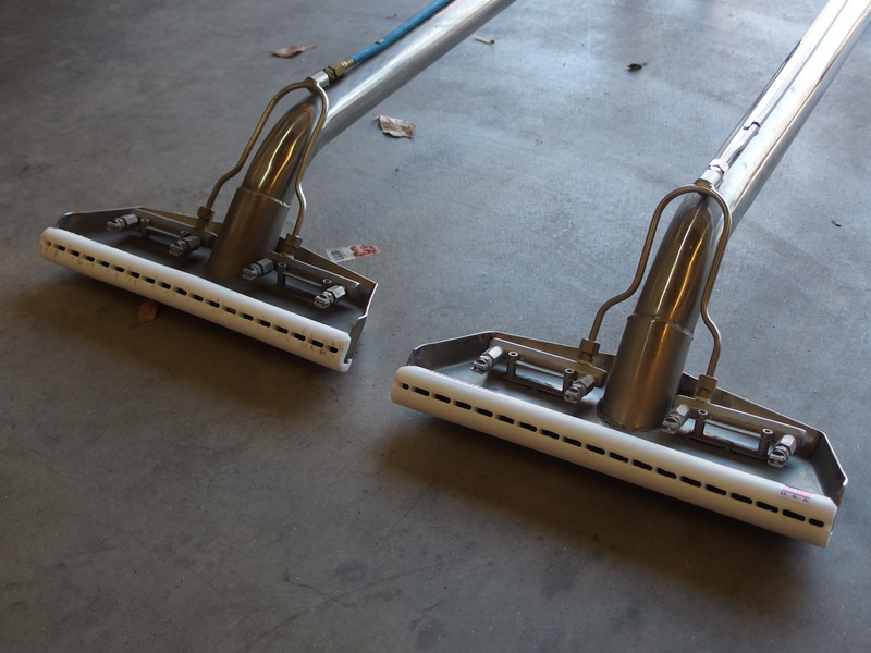

  • Small holes glide: Easiest to move across carpet. Better for OCD, ADD, somewhat wimpy BB hoopla type personalities. You'd better Wernerize the hack out of the carpet prior to cleaning. No agitation at all from the glide. Will last longer.
  • Hybrid: Neither here nor there.
  • Slotted: Will pick more debris. Will last a little less. Agitates the carpet more. Need somewhat more effort to move the wand compared to the holed one (nothing major). Designed for real cleaners :winky:

Actually holes give the best water recovery and the easiest push, but they don't pick up debris any bigger than a frog freckle and give the least "wand lip" agitation. Popular with guys that do a lot of higher end residential and commercial offices, religious pre-vacuumers.
The slots have the poorest water recovery and the hardest push (still tons better than a glideless wand, but of the glides it is the poorest and hardest), but it picks up the most debris and gives the most "wand lip agitation" of the glides. It is popular with guys who don't pre-vac, and/or do a lot of apartments and restaurants.
The hybrid is in the middle for both performance and pushability. It will pick up debris up to about the size of a sunflower seed.
Also - the smaller the machine the wand is hooked to, the bigger the difference in dry times between the three configurations. If they are using a porty or small TM like a Bane or #3 blower unit, the difference in dry time between a hole, hybrid and slot will be huge. If they have a big TM with a #5 or 6 blower like a Vortex, Aerotech or big SteamAction, the difference in dry time won't be noticeable at all, the big difference will be in ease of push for them.

I am not a religious prevacuumer, (I am neither), but I have found the hole glide to be the best for my Ti wand. I had the hybrid glide and it was better for picking up debris, but for ease of use, nothing is better than a hole glide. It flumps over debris, and when you are through with a room you need to take your vac hose and pick up all the little pieces the wand didn't extract. That can take up to 45 seconds.

After I got my short slot glide I brought in both wands that were identical except one had the hole glide and one had the short slot........
I ran them on different type of carpets and then with 2 different machines....I did for over a month side by side..it was fast and easy just to change the wand..in the end....I now have a short slot on both wands.......any one want to by a very slightly used hole glide for a 14 inch westpac let me know because it will never go back on my wand....
