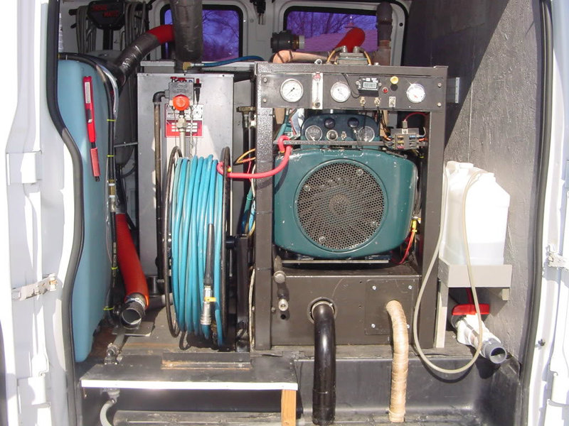

Is your metal van floor covered with something(insulation, plywood, mat or carpet)? I have my LG raised up off the floor surface about 4". Assorted005.jpg

crazy lookin setup you have there, very clean . Is that like a rebuilt hydro genie truckmount ?
Its and old TurboTech Commander. The only original parts are the frame and the clutch switch. 23 hrs Kohler coupled to a Roots 45 with a Dodge coupler, Cat 340 and 95 gallon SS recovery tank. Its a great unit, been my back up now for 7 years.
