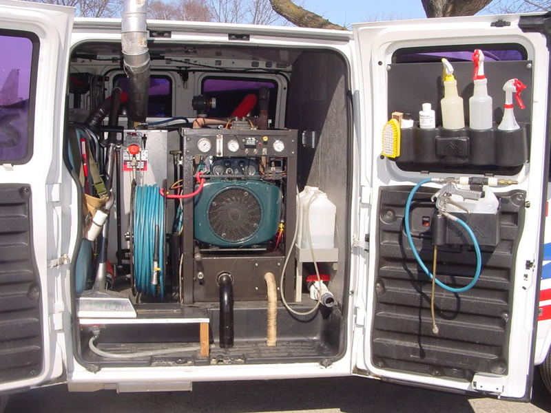

This is what I've done to vent the LG outside. One elbow on top of the heater, a length of pipe out to the side of the van, and another elbow that I can put on when I open the door. Works great and has absolutely no negative effect on the heater performance.

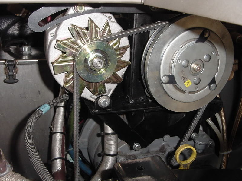

When I first got my PowerClean Victory I would only get 40-50 hrs on a set of belts. I made many changes to the system and most of them helped to where I was getting 400 hrs on a set of belts. After the charging stator on the Kohler failed for the second time I decided to design a bracket and install an automotive type alternator. Originally the Cat pump was run off a pulley from the blower so I by-passed the blower and ran the belt off a pulley directly on the engine. It seems that taking pump belt off the blower reduce the stress on the blower belt. Since this modification I currently have almost 1000 hours on my belts. I should also mention that I also installed one of these brake cooling fans http://www.ebay.com/itm/NASCAR-RACE-CAR ... 4842847fe3 and ran the hose so it blows cooler air on the belts. The Victory used 5" pulleys and larger ones would have been nice but space wouldn't allow it in my case.
I did have to install a larger pulley on the alternator as the smaller one pictured didn't make sufficient contact with the belt to prevent slippage.
