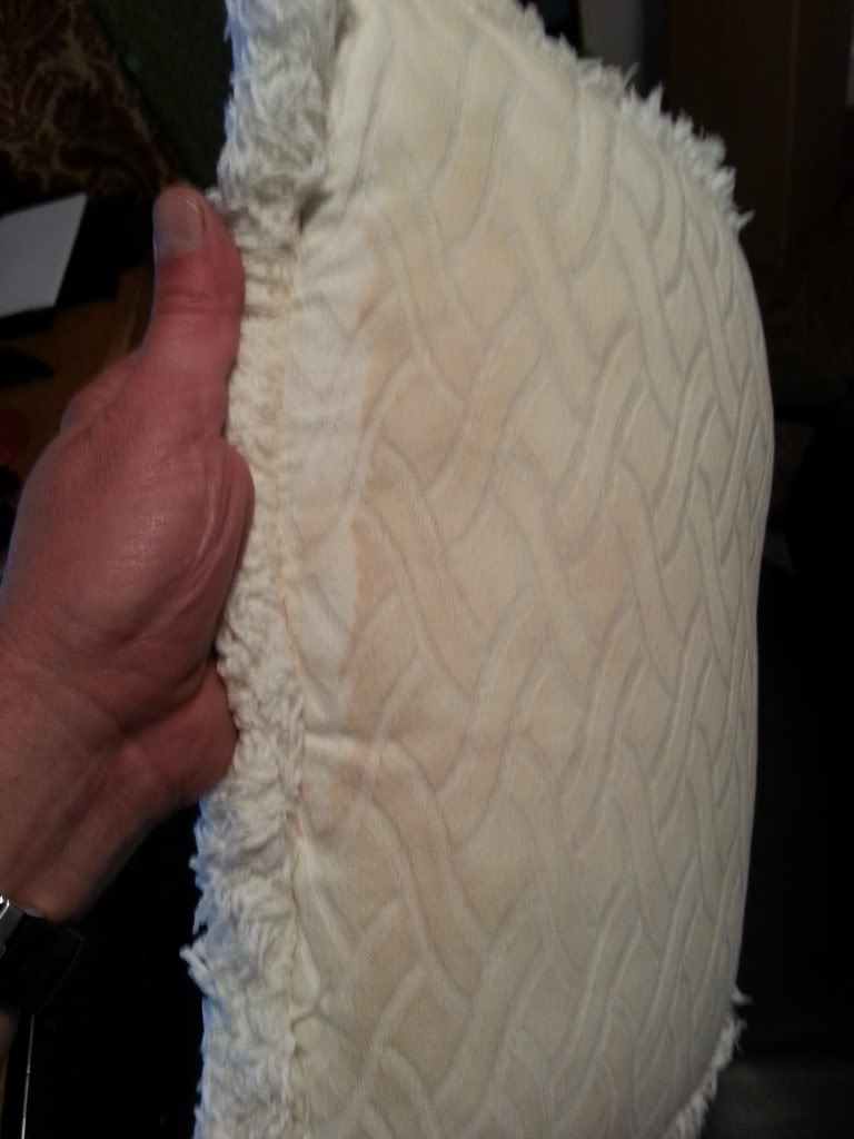

A lady down in Salinas had her raw cotton cushions man handled by a careless cleaner.
He tried to fix the "Haitian Cotton" but only got about half of the browning out.
Now it's my turn
What would YOU use to correct the chem burn and charge for doing so?
She will bring them to me as well as pick them up when done.
View attachment 1205View attachment 1206View attachment 1207
her cell phone pics, sorry

I had a customer have me clean some chairs like this once. There were lines on the cushions that looked like the wicker bled onto the fabric. I couldn't get it to come off. I assumed it was from the wicker. Never thought it might be browning.
The chairs had their back to a window that got alot of sunlight. Would browning treatment have taken that off?

If he tried to clean with one of the Haitian cotton cleaners, it is not a chem burn.
Again, if he used a Haitian cotton cleaner, the residue will most likely neutralize the peroxide (as Dave suggests.)
Let chemistry do the work: I'd clean it with a Haitian cotton cleaner mixed correctly, apply generously, let dry in sun light and vacuum very well after it is dry.

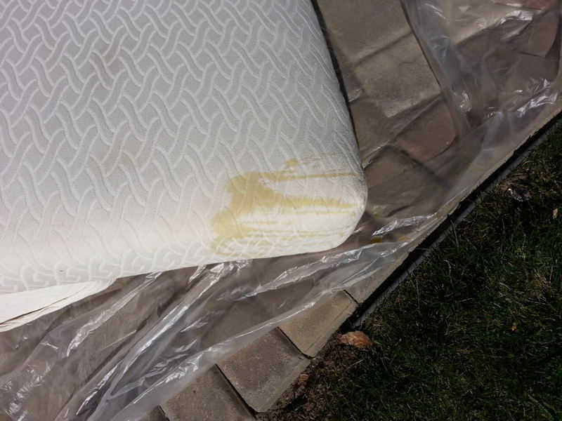

View attachment 1211View attachment 1212
This cushion was turned brown by poor cleaning and some diluted power gel from pros choice and spraying diluted citric acid improved the browning. A finish application of 20% peroxcide and hair dryer took out brown.
I would slowly test some products and dry fabric before proceeding.
Lots of testing on some fabrics because too much peroxide can damage and turn some cottons gray. Acid rinses and sunlight is safer, just slower.

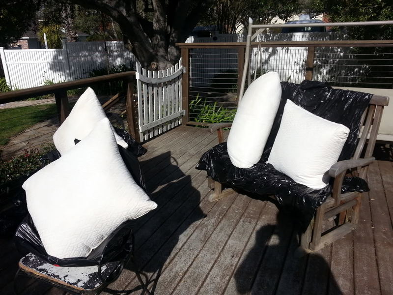

I'll start with a light acid rinse through the machine first to get out the unknowns then I'll use the sun and 3% to correct whats left, followed by another light rinse.

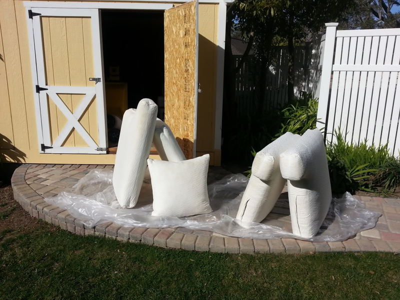

the worst of it..
fixed!

All I'm doing with the more than powerful enough Mytee is rising the unknowns out.
The 40 diluted to 3% with distilled water is doing the magic..
I'll do a final rinse with the tm to get the peroxide out when Im done bleaching.
The $500 is given...
