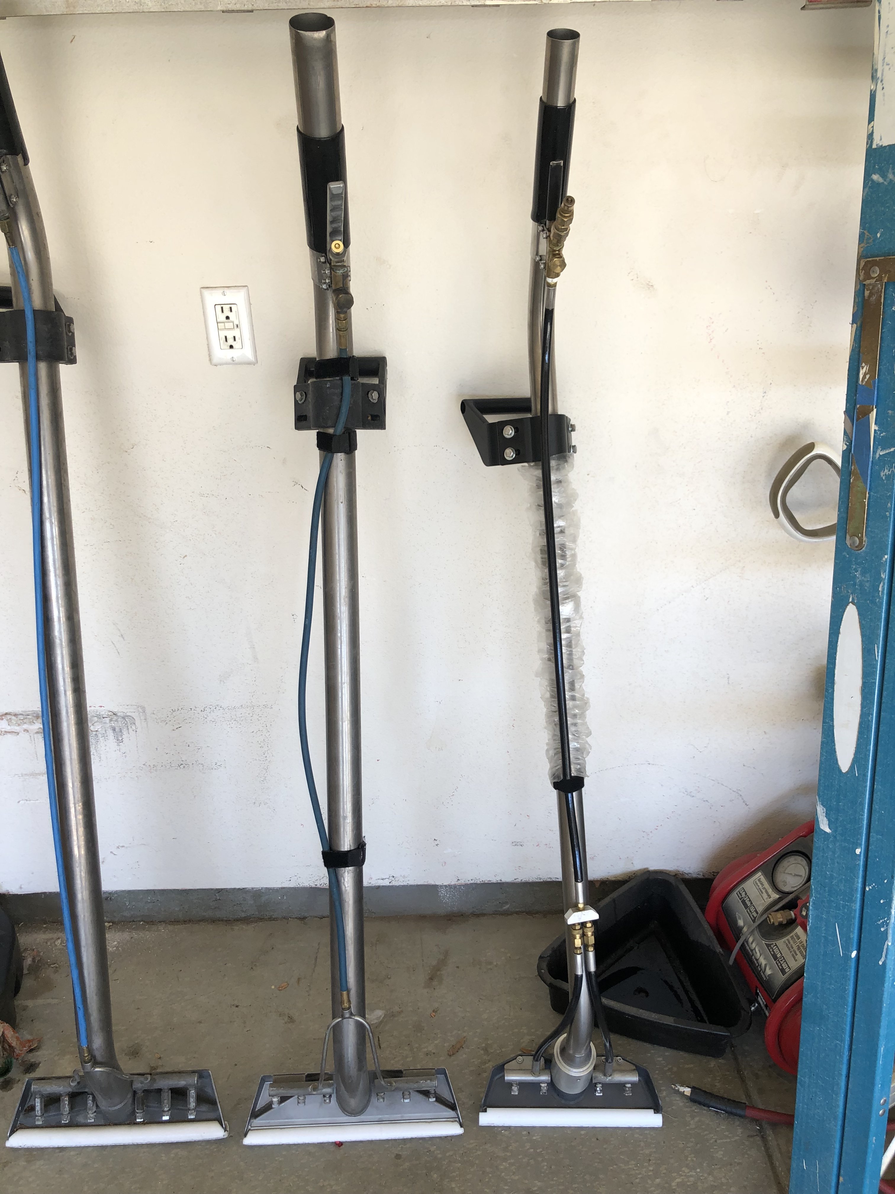

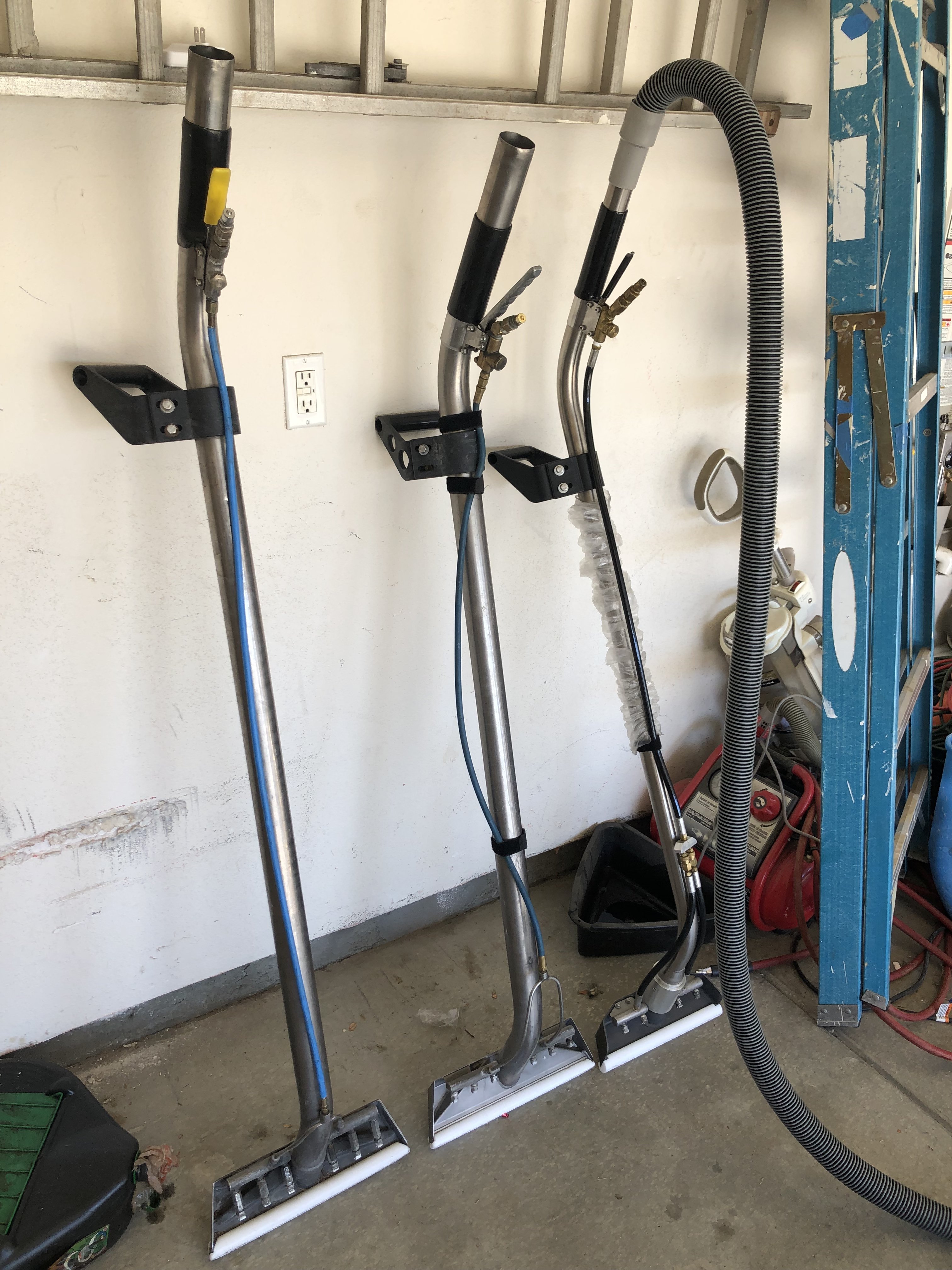

Got the traveling wand. Feels about the same weight as my SS 14 inch Ti.

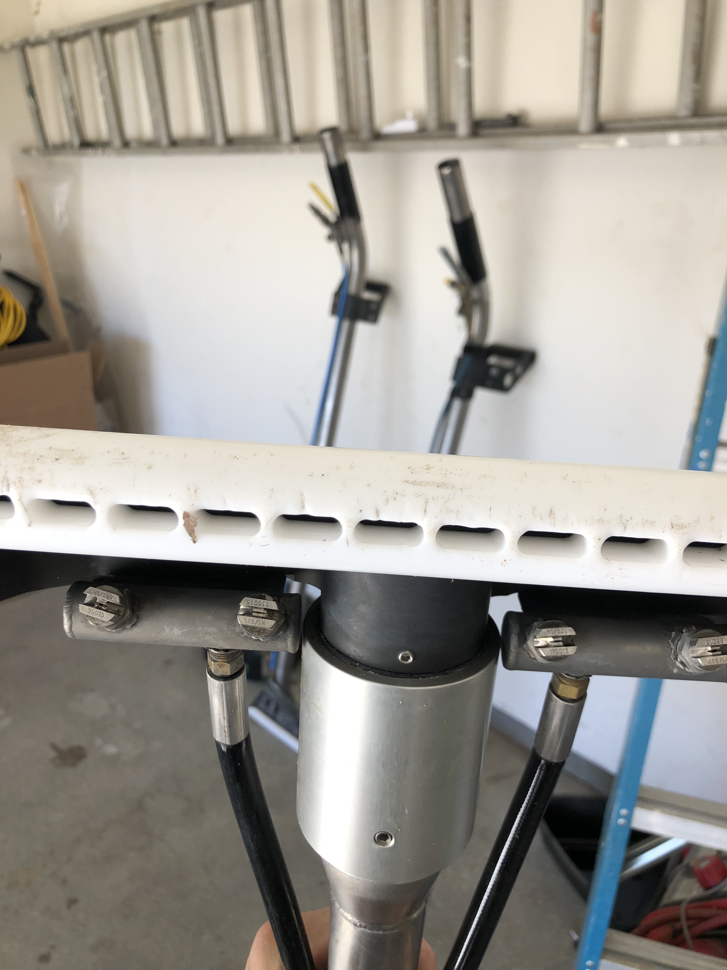

The jet have been set at slight twist angle not sure if that user adjustments or the way Tom set it up. Have a stop tomorrow to try it. Hopefully I have it more then a week to test.

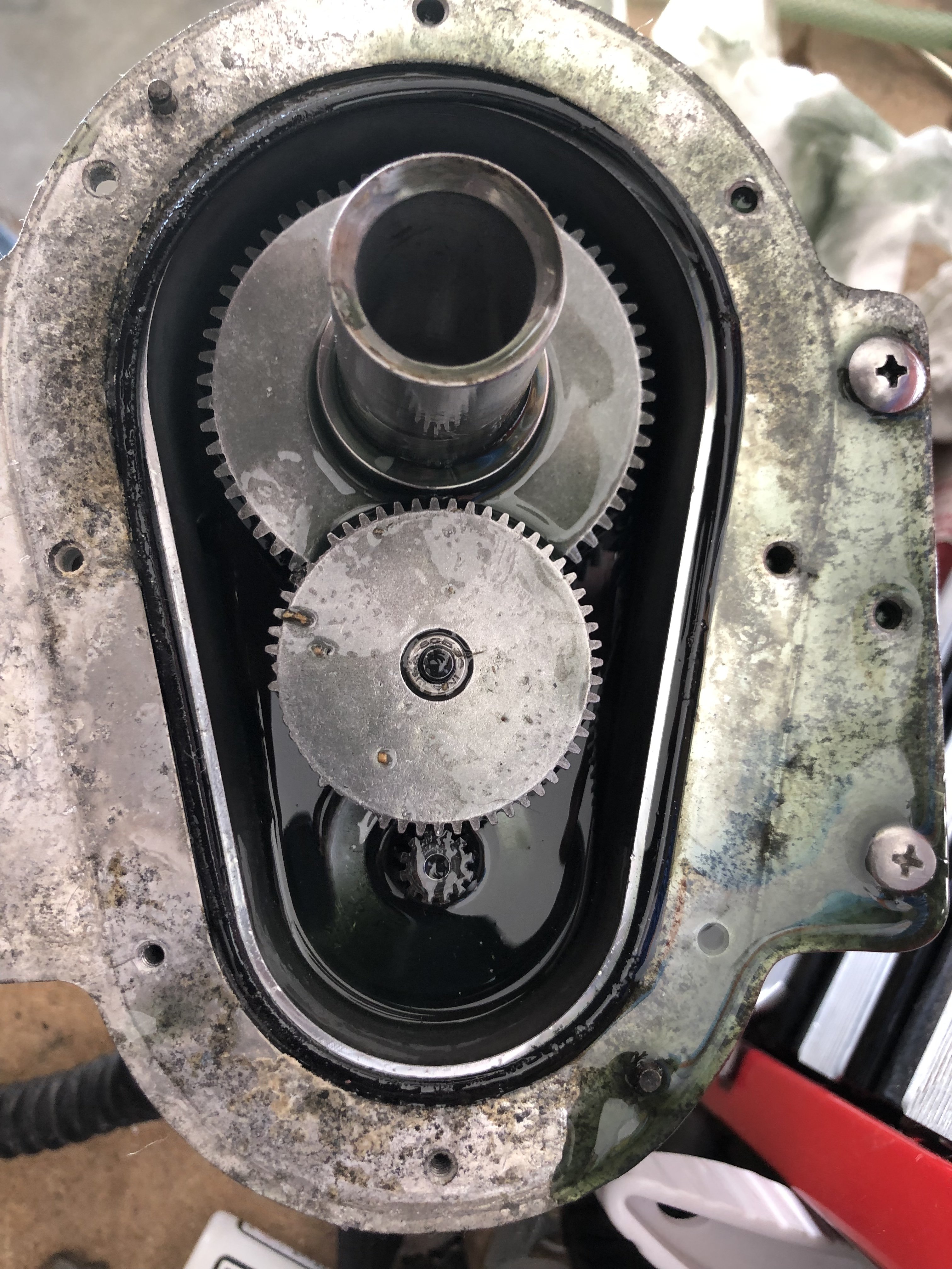

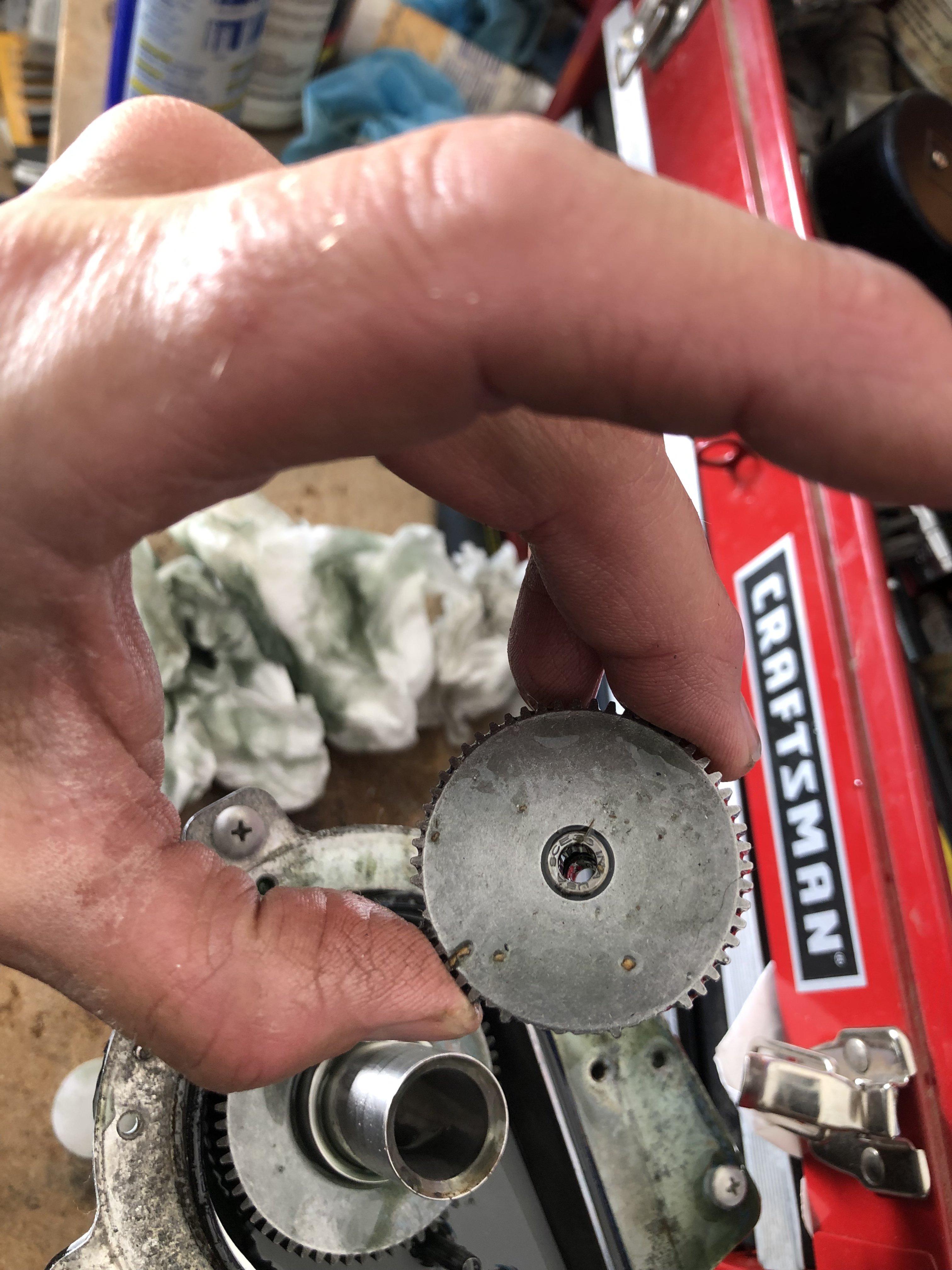

Tore up my 360i on a touch Friday so mad a over reached on a quick pass and cought a door metal molding and grinding chewed that biotch up.
Ordered new gears from Rotovac.

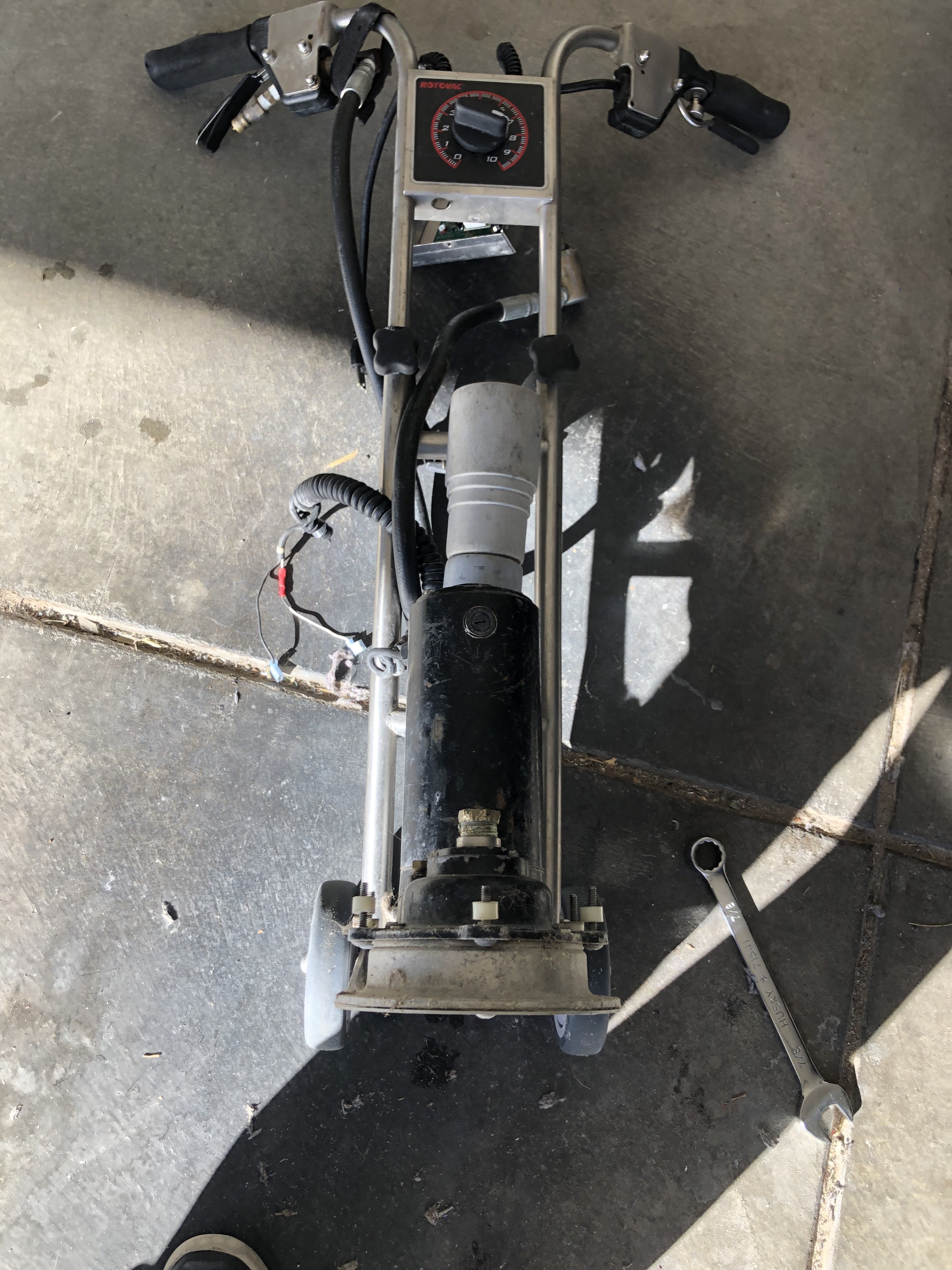

damn it, 360 started smoking today... taking it back to rotovac tomorrow. Hoping theyll let me demo the new model thats coming out soon, they said couple months itll be released. Im on the list. In the meantime looks like new motor $595, seems pretty over priced for a small gear box.

Make sure it's not the cord. Mine started smoking last summer and one of the guys at RV said it was gearbox or motor but I ordered a seal & bearing kit. Installed all the new parts with new lube and it still wasn't right. Pulled the extension cord off the CRB and the RV was fine. Switch out the cord before ordering anything.
