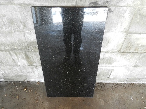

I have my slab of Granite , now I just need to know what type of products I need for the practicing process to start.
What will I need to do to make this granite dull so I can shine it back up?
I'm ready to get started and any help will be appreciated.

Call Rob @ hardrock tool for supplies...
I like to use a 7" Makita, (I have heard some like smaller for tighter areas)
From Hardrock... Stone pro's
StoneScrub,http://www.stoneproonline.com/Stone-Scrub-33-60-prod.htm
Pro-polish crystalizer an extreme hoghair pad, Potea powder,
crystal clean (neutral cleaner), Sealer http://www.stoneproonline.com/Ultimate-Pro-34-36-prod.htm
And Finishing touch revitalizer and lots of microfiber towels.
You can start by literally hosing it down with a tap or even softened water
let it dry, and repeat and repeat to mimick the daily damage done to granite by the home owner.
Hope this helps...

Hi Bruce,
Here are the products to make that Black Galaxy look new again. I sent you some pricing information in a PM.
Step 1 Stone Scrub 1 qt. Cleaner
Step 2 Potea 1 lb. Adds color
Polish Pro 1 qt. Reflectivity
Step 3 Ultimate Pro 1 qt Sealer(opt.)
Step 4 Finishing Touch 16oz Final Buff
Accessories
3 7" Hogs Hair Extreme pads
1 7" lambs wool bonnet
