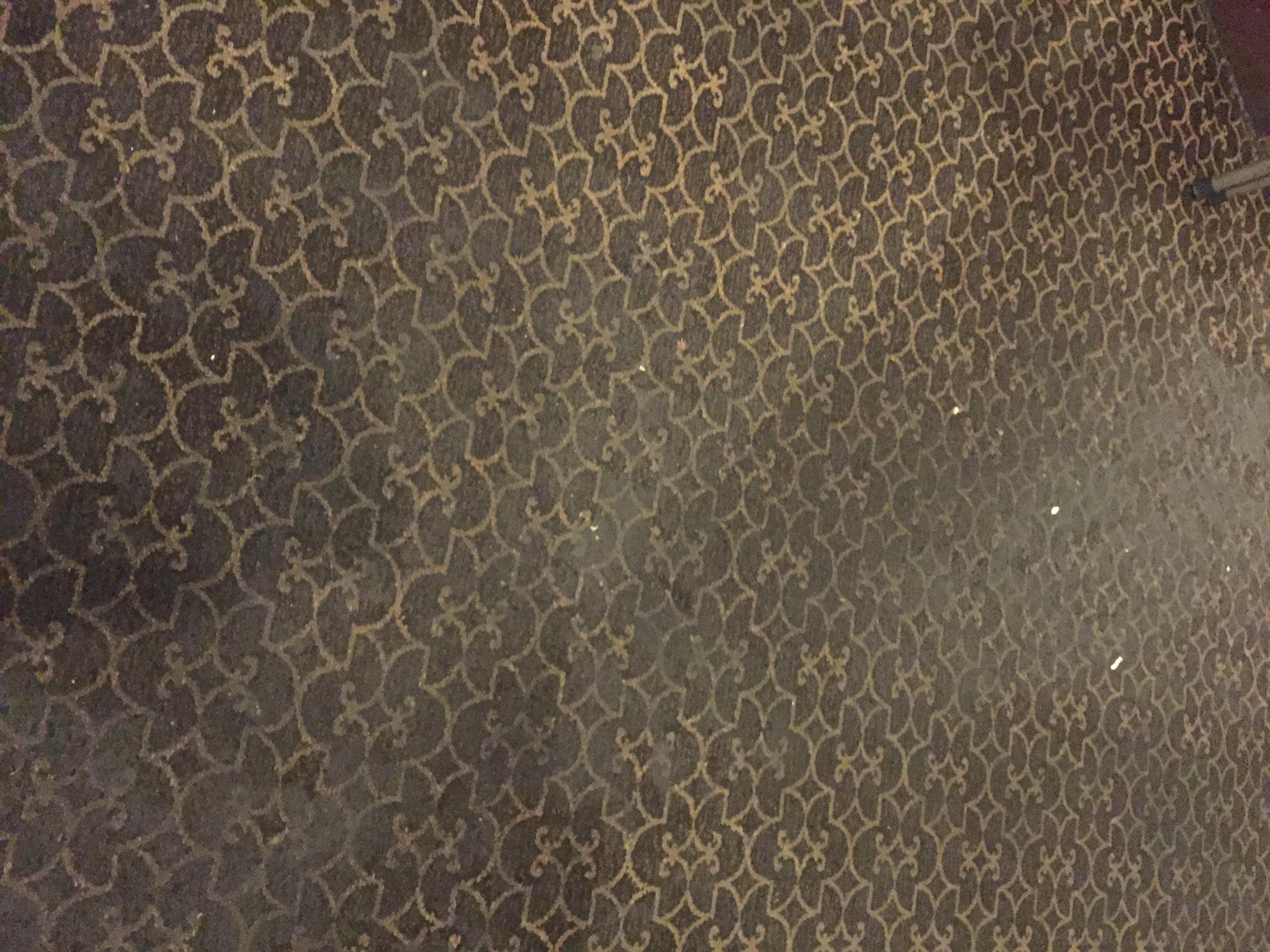

What steps would you take to clean this and also make sure it does not come back in the next week or two?
This restaurant is a seafood place and this is coming out of the kitchen.

Everything from incorrect mopping technique and products to how they do their food prep and the shoes they wear contribute to resoiling.
Use a strong product to prespray and possibly scrubbing dpending on type of carpet and a FWR at high temp to clean will leave it as residue free as you can get.
Some will post encap to help resoiling but I don't find it helps and most restaurant's don't want to pay enough anyway.

Use an enzyme prespray like prochems power burst and rinse with an alkaline extraction detergent. Use a rotovac with brush head or a crb or 175 with a red pad for agitation. No matter what you do, it is going to get dirty quickly. They will be tracking grease out of the kitchen immediately.

Powerburst with a prescrub will make it purty for a week or so.

I've seen worse carpet in restaurants. You could hit it with a strong HWE cleaning. Grease Eater is an effective prespray for restaurants. A post encap can help it too! That'll help it to look good longer between cleanings. And once you get the carpet restored (if you can get them into a routine of monthly maintenance) you could keep it looking good with a solid encap program.

Popping that solid load off is mostly chemistry, not a big deal. Convincing the owner to pay for cleaning every month, every two months is the insane part of it all. That level of soil (as was pointed out) is kitchen procedures, shoe wear and complete lack of everything. Four years of restaurants for me, never again.

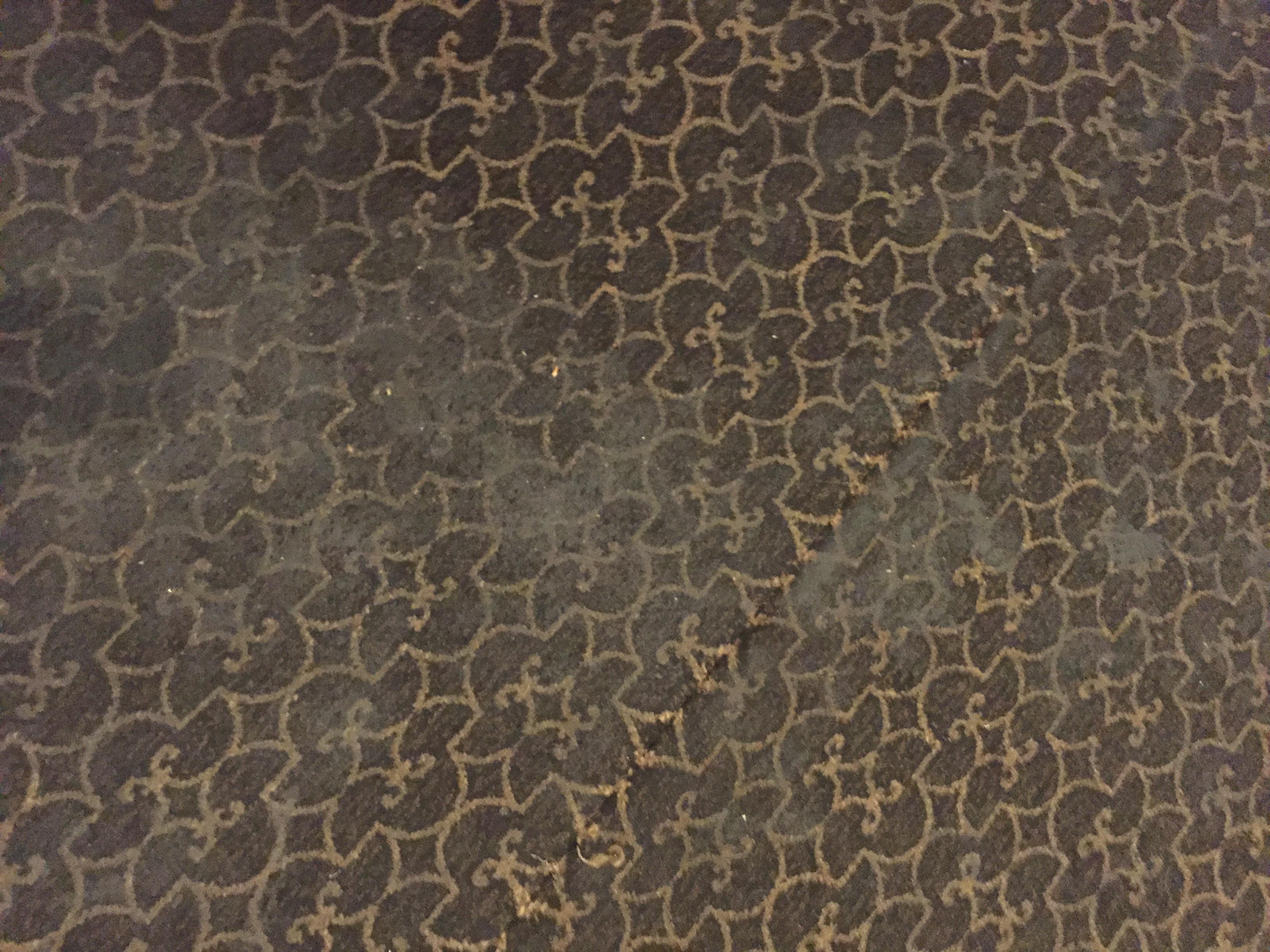

Try dry extraction (absorbent compound)
...aggressive pile-lift/vac (lots...clean the brushes couple times)
...pre "mist"...not over-wet "spray" just
breaking the surface tension
...apply compound machine brush
...when compound turns black,
vac/vac/vac
...re-apply fresh compound...do not
re-mist...brush
...repeat as necessary
...charge lots cuz you'll save the carpet

Sorry, didn't read the whole thread, but for us, good quality detergent and prescrubbing with a rotary or CRB followed by proper HWE (Hot water extraction) has often produced excellent results on neglected restaurant carpet. Extra good touch can be leaving airmovers to assist drying for quick usage of areas cleaned.

The greasier... the drier helps save
time/money/corrections, though kinda
counterintuitive.
