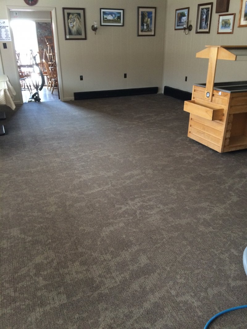

Greasy, Grimy....oh my.
This one gave us a run for our money last night.
Has been 10 months since they had the carpets done.
They spent money on a kitchen remodel and additional equipment, so carpets got put off the the side...and this is CHEAP carpet!
Had all the tools off the truck and few other chems to try....
Ended up being a lot of wear coming out of one of the Kitchen spots....
Some areas we were able to spray on go...other areas just faster with some CRB agitation...Red pad, Rotovac 360 XL....no matter what the tool....was just plain tough!

I wish you would have side by side with the Rotovac xl
Unfortunately, the camera battery didn't survive and we were getting behind on getting done and getting the night help out. Was a really bad carpet and uneven floors.
The CRB and Zipper combo ended up being best combo on this one... But it challenged everything!
