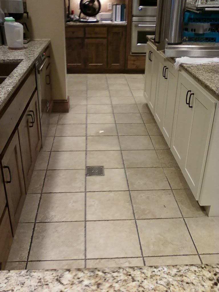

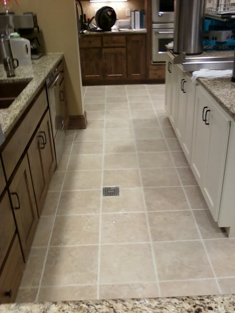

How long would it take you to clean and colorseal this greasy kitchen floor (about 250 sq ft of exposed tile)? And, How much would you charge?

looks nice but the wrong color was used in my opinion. grout always looks better when it matches the tile.
i have never understood why people want bright white.

white always screams clean on a tile floor. My response from customers is they are used to it. I agree the whole point of color seal in my opinion is to add the color that best suits the tile and it will stay that way. My customers shy away still fearing it will fade just like their powdered colored grout did. I hear about 2 out of ten tell me they wish they went the color way when we return to clean the carpets but they never want topay to change it :lol: .

Two of us could apply the sealer in under two hours
So, I should not feel too bad that it took me 5 hours to clean and do my first colorseal.

Looks like one I just did
444 square feet.
$1.00 to clean
$1.25 to color seal
Took me 5 hours alone.
Friends-friend 20% discount.
Still netted $800.
Not too Shabby.
