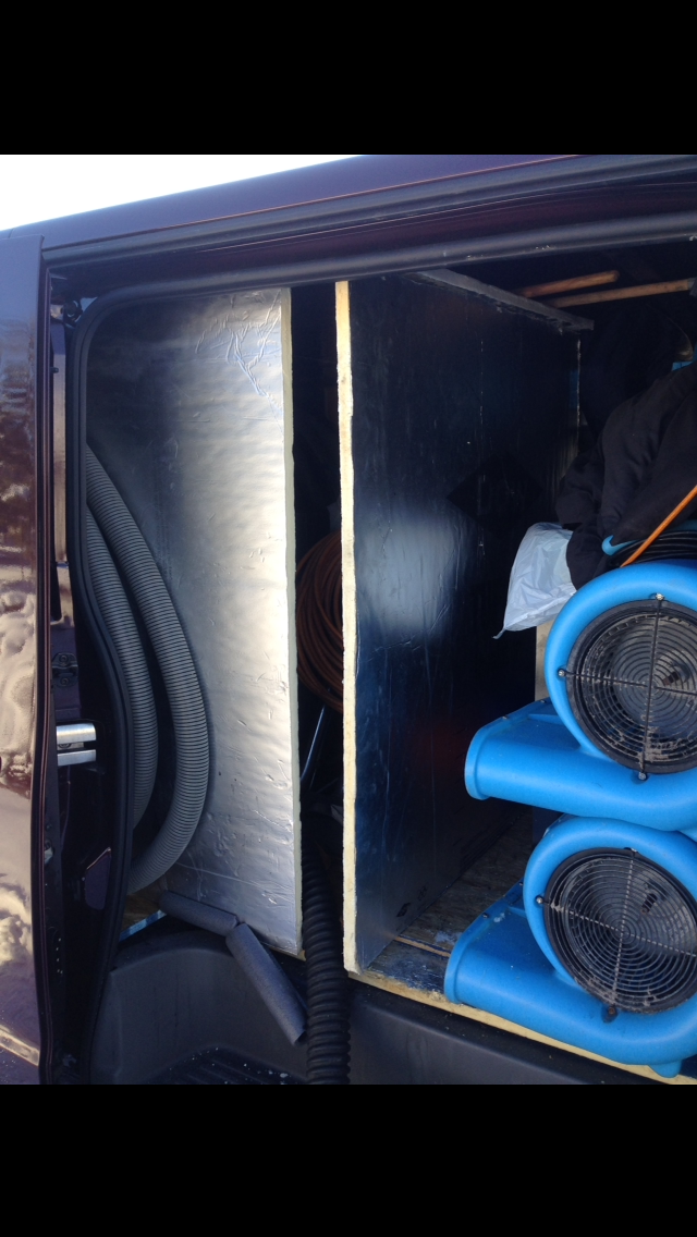

Pic 1 - all freez-ables are boxed in .. black hose hanging out is engine exhaust (blower exhaust heats the van)

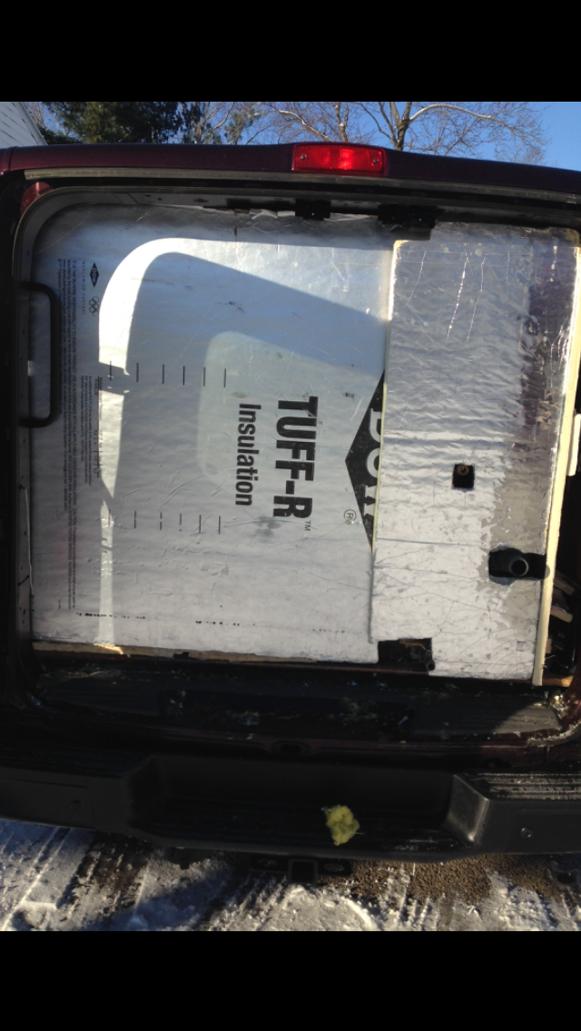

Pic 2 - Ill use board on the right to keep my panel items from freezing - cut out for vac, solution and pump out

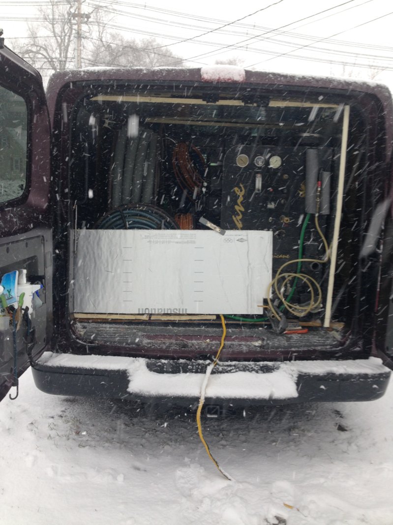

Pic3 - Ill use this board along with the board from pic 2 to keep things warm
Closing the left door leaves just enough air flow to feed the engine and keep things toasty inside
