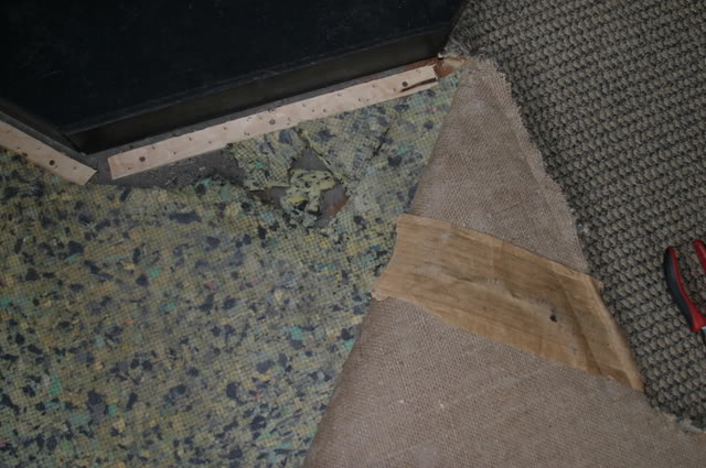

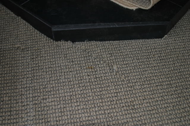

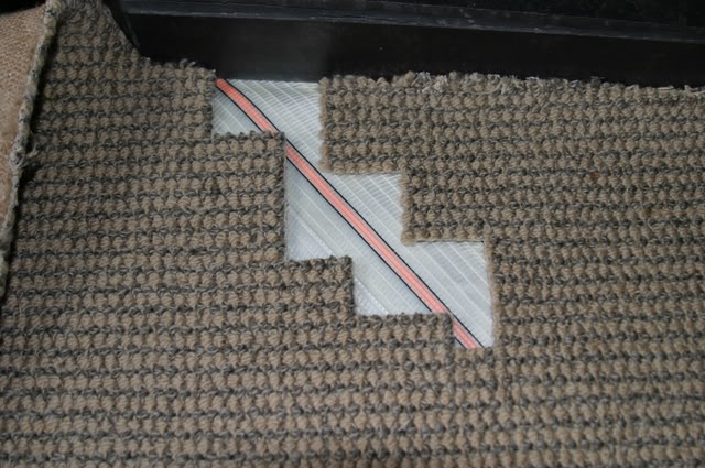

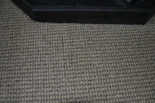

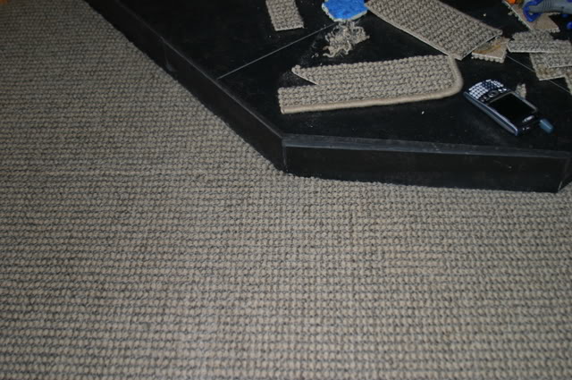

Hack install a couple of years ago for the poepl that sold the home to my clients.
Cut a straight line out too far, across the angle and slapped a bit of tape on the back and a quick 'she'll be right mate!" and he was on his way.
The clients had all bound and used mats which worked out great as I had to do a total of 4 different repairs for this client and was able to use different sections throughout one mat to match wear.
If I had simply done a large square, it would have shown and be a lot more obvious.
Think outside the square :p with repairs.
