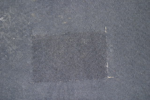

I was called by this client to clean her lounge room 'while it's empty'.
I get there this morning. The whole lounge room is totally bare. She had booked a repair for an iron mark with a carpet retailer that doesn't send me any work.
They told her that she would have to have the room clear of any furniture. She spent an entire day shifting the stuff. She is late fifties and lives alone and no family in the same town.
They came in yesterday, spent two hours and charged her 177.75 (that's $158 + tax) and left this mess :eek:
She only had the one mat, and they used the whole thing for 4 attempts before they got it to this stage and ran out of mat and decided this was as good as it ever was going to get.
I wasn't going to say anything but she caught me checking it out and asked my thoughts on it. I opened my big trap and said too much letting her know that I could have done it for 2/3 of that price, be in and out in 3/4 hour and she wouldn't have had to shift a single piece of furniture.
Guess who's on my list for some mailers 8) with some very good before and after photos :?:
In actually asked her if she had any over and I would have done a freebe for her but they left nothing. I still offered to try and clean it up a little for her but she said that she was disputing the invoice so didn't want another contractor touching it yet or at least until after the manager had seen his tech's handy work.
Makes you sick doesn't it?

if you would, could you explain all that is wrong so when I start to practice I can watch out for these things. I know it straight out looks horrible, but what did they do wrong to get it that way?

Looks like they used a straight edge and cut past the mark on nearly every corner for starters.

Charles,
a few things. Like Tony said, he has over shot the corners on both sides on each of the four corners.
Now I'll often on smaller repairs run past the corner but it's only on the run and never across.
Secondly, he hasn't had any regard for the rows. That carpet could be cut BOTH directions without cutting any tufts.
It isn't square so he's gone across rows.
I suspect even the nap is the wrong direction meaning each carpet is manufactured in 1 direction. If you get a round pencil and paper. Place the pencil over the paper and roll your palm over the pencil with a bit of pressure back and forward and the paper will move one direction under your hand. You do this on both the install and the donor to find out which way to install.
There's not much that can be done regarding the use of near new donor into worn and faded carpet but that is out of his hands... yes, Tony and John have both told us about adding a bit of colour or stressing a donor first to help blend in better.
Others may have picked up other things, but they are what jumps out at me.
