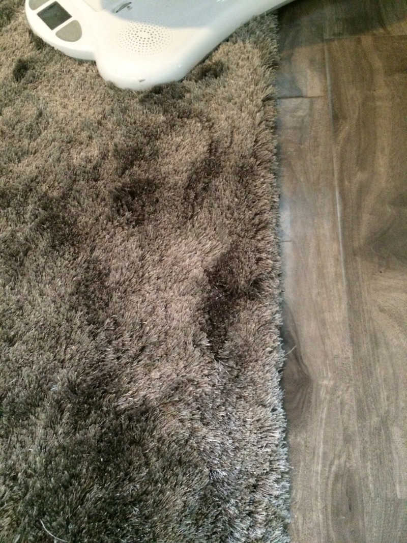

We are debating on cleaning this one or not, have not cleaned this type of rug before..
It is a hand tufted faux silk rug, no urine problems, or staining, they just want it deep cleaned. Does anyone know the suggested cleaning process for this type of rug?
I would prespray with Pros C
hoice natural fiber cleaner 1 oz per qt, groom, rinse with HWE acidic rinse maax psi 250, groom alot and regroom while drying
KevinL
Jan 5, 2007
2,929
Kevin Leach
WE just cleaned one exactly like that yesterday. After beating all the crap out of it we presprayed and hosed it down. Ran it through the machine and hung it to dry. Came out great.
