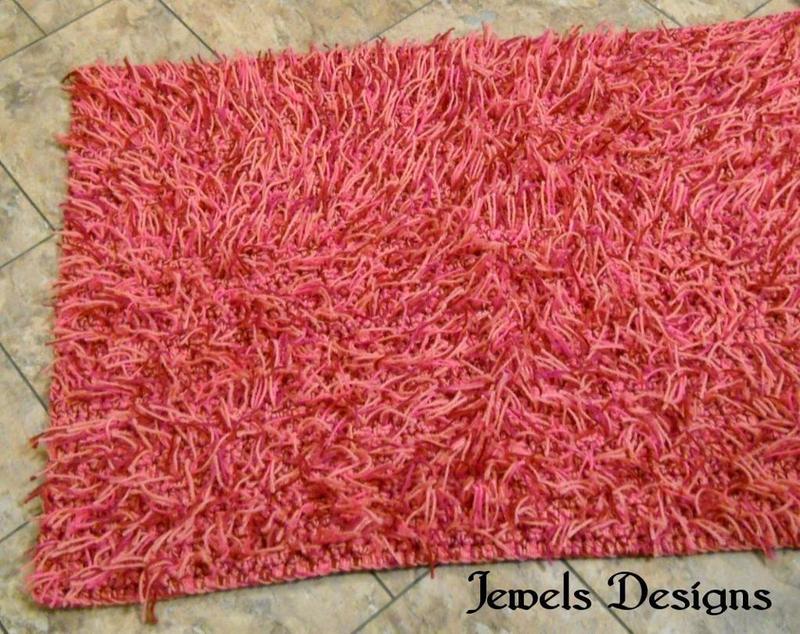

Ive cleaned Chinese shag back in the late 80's .. looking alot like chef boyardee !! It was similar to this and it was wall to wall - hated it !!
