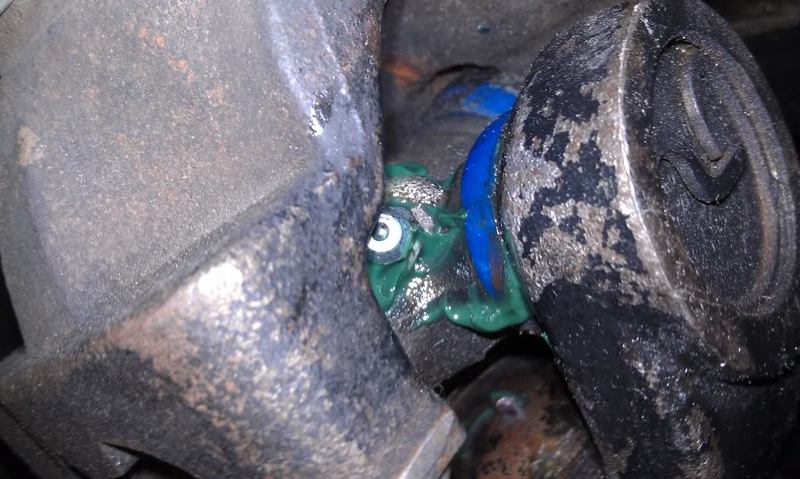

I have struggled to reach these zerks on the u joints of the pto. I seemed to manage for a couple of years. I got new u joints recently and I cannot get the coupler on the zerk. I would change the zerk, but would have to take it apart to get to it. I'd rather not.
Is there angle coupler or thin wall coupler that I could use on this? No @ one NAPA can seem to find anything.

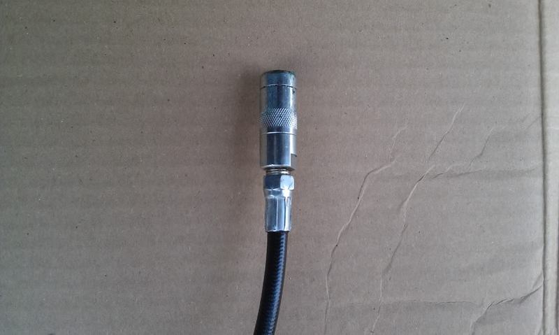

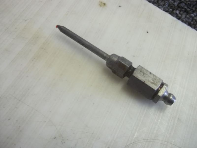

This is what I use for the hard to reach Zerk fittings.
