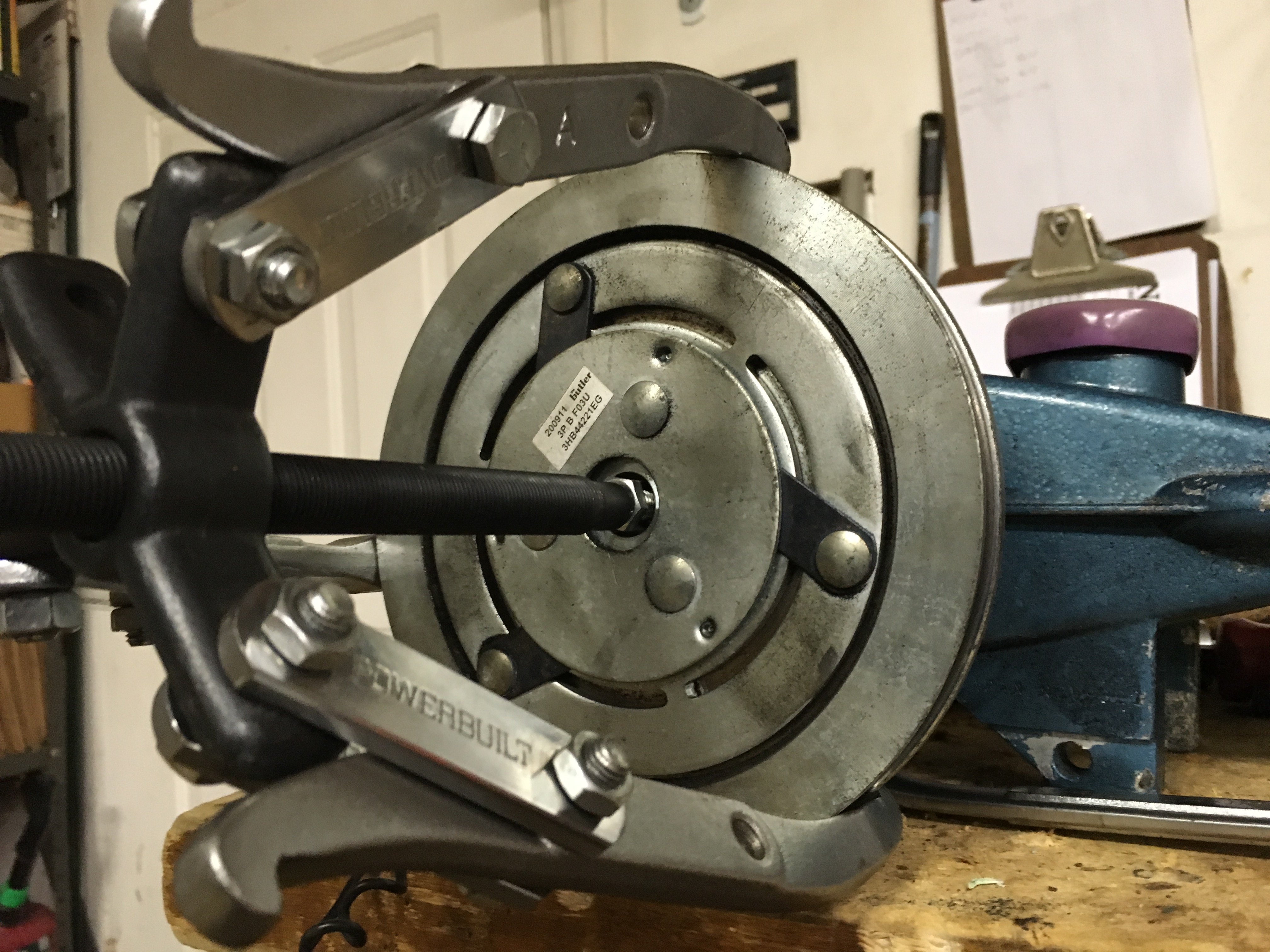

Looks like my set of jaws will do. I was afraid of stressing the pulley.

The pulley came off really easy. I used a slightly longer shaft bolt to set the clutch on my replacement pump shaft. Everything else transferred over to the Cat 430 pump just fine and it was up and running quickly.

aren't there threads on that clutch that you can send
a bolt down the center to push it off the shaft......
i see that pulley distorting already from being pulled wrong
Enlighten me Bawb, how is it being incorrectly pulled?
You can see in the pic that there are no threads on the clutch for removal, like you would see on a harmonic balancer.
It popped off really easy with the jaw puller using very little force and without any distortion.

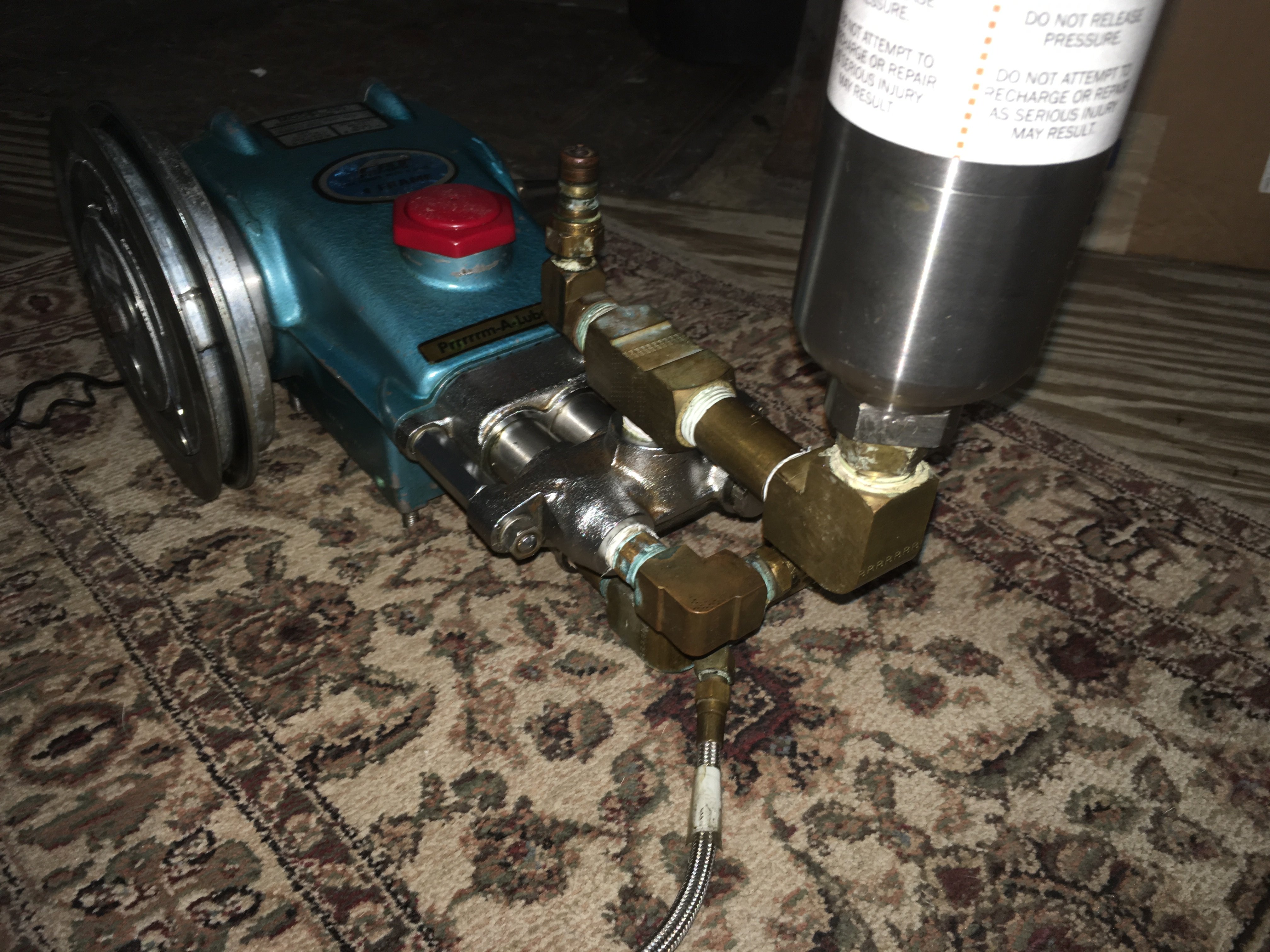

The 2nd pic is of a Cat 430 pump I setup for the Butler with chemical injection deleted.

OK NEWMAN......lol ....the center hole of the clutch has threads. ..3/4 maybe 7/8...if you run a correct size bolt down thru the threads it will push the clutch right off the shaft
Of course you have to remove the center bolt that' holding the clutch on first.....
Just razzing you Bawb, you have forgotten more than I will ever learn! The only threads are on the pump shaft itself. Nuttin on the clutch.
