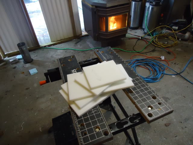

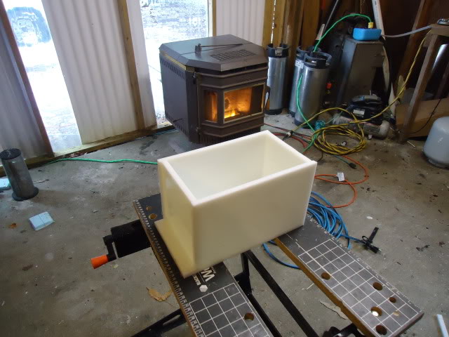

making a water box for a customer with an outdated truck mount exact copy of the current leaky one out of hdpe plastic

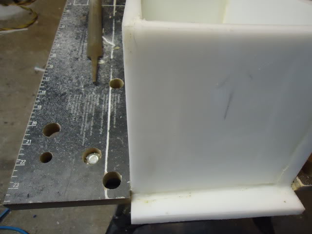

i would LOVE to see a close-up of that bead...
does it look like a tig weld......
show us yor nervous tic........

you cant thread this product do just about anything with it as you can with metal even with heat bend it.
still takes the same time to prep and weld this stuff as anything else
you can only weld the exact same material like hdpe can not be welded to Uhmw or Delrin

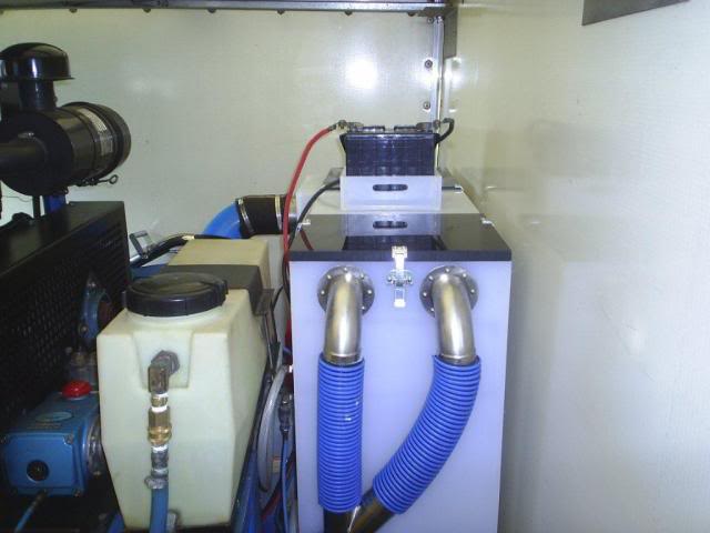

Here is a waste Tank of the SAME material...yes it can be threaded... 8)
Also you can "customize any thing you want on it.."Like the battery box on top"..
