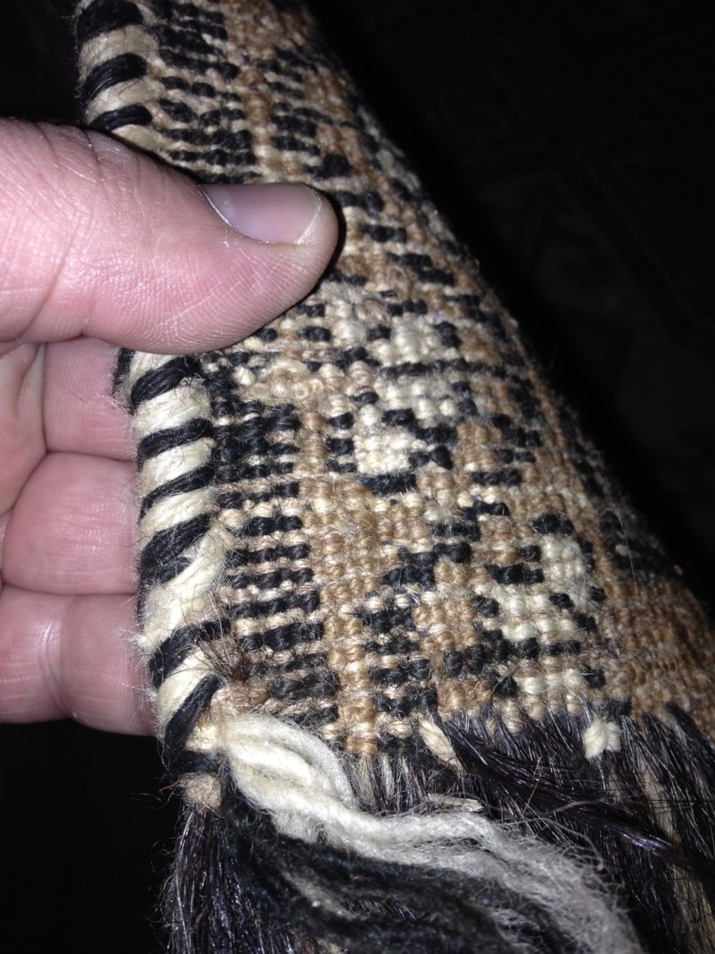

Photo of back

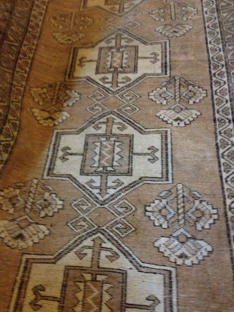

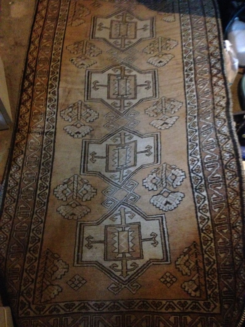

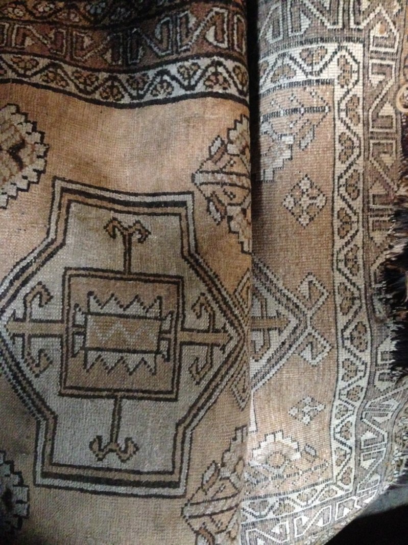

Front

117,348
I highly recommend you get that to a rug plant for top down dusting, possible dye setting, possible blocking
unless they don't care and will be happy with any outcome, possibly stinky, bled and out of square..
