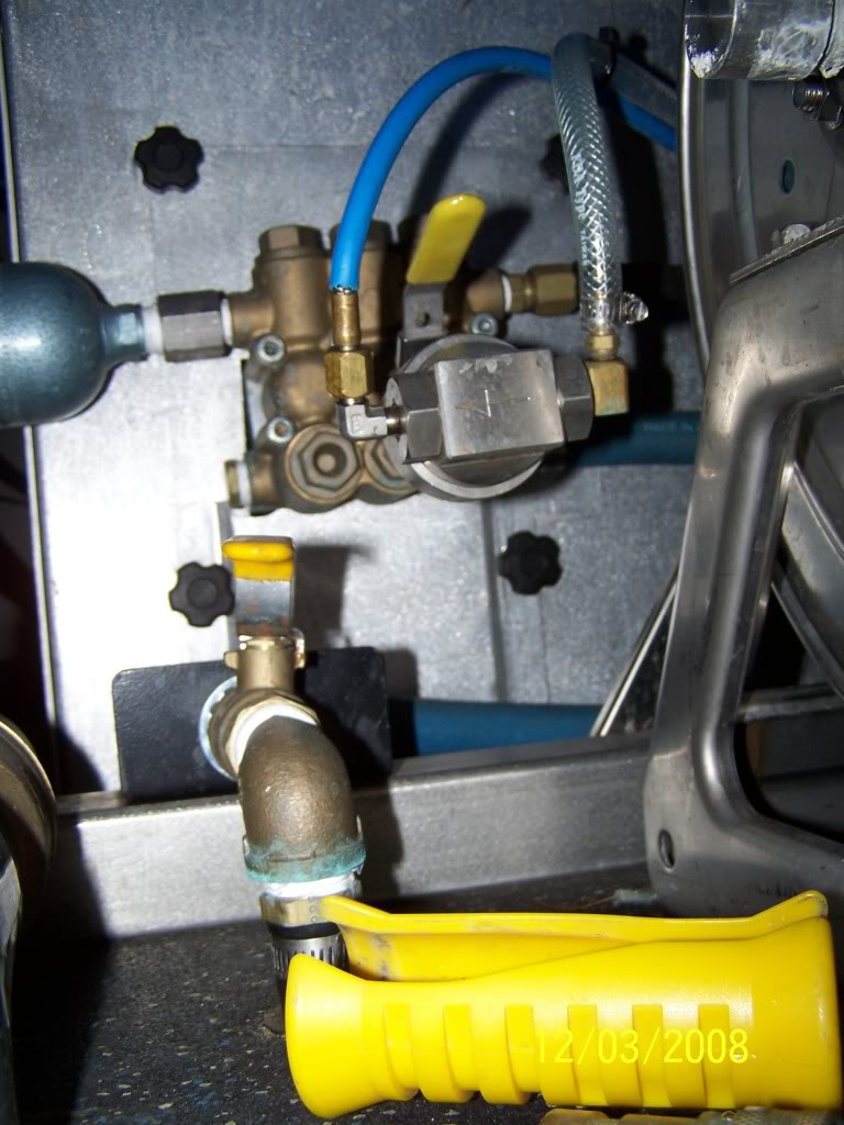

Billy, You have to be very careful with the pump. I had Chuck Cushman fabricate these covers for the gap around and under the pump .

My pump doesn't have the cover. I have a 2004 6008 model.
