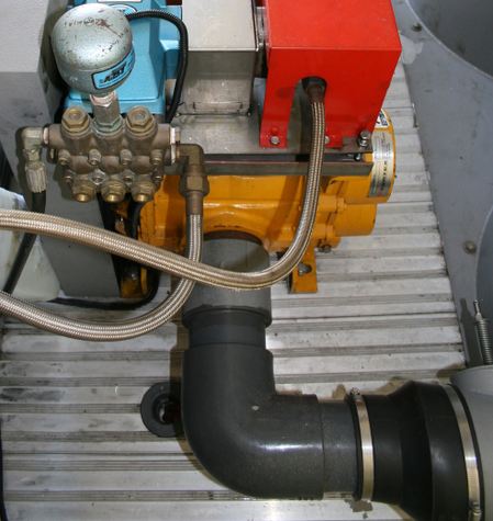

Here's a Vortex picture posted earlier (courtesy of Wizard), that shows their 4" (edited from 3"per Greenie) PVC plumbing quite clearly:
Notice the rubber reducing adapter on the right.
Larry
G
Greenie
that is 4" off of a 4" port 5009 blower which enlarges to 6" at the tank.
this will be my one and only comment on this thread, there is much misinformation here, and engineer would have his eyes rolling back in his head at some of the justifications.
