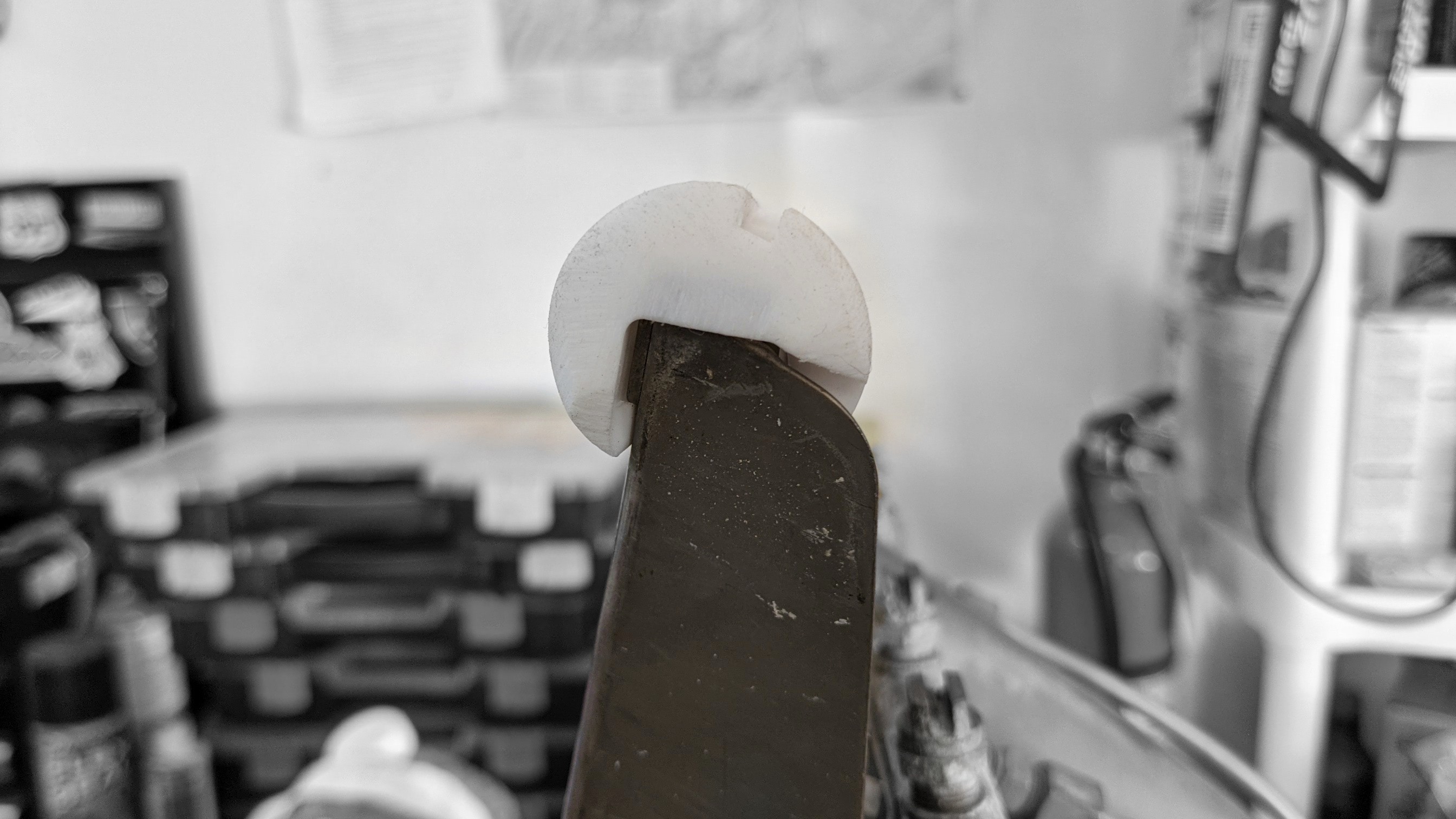

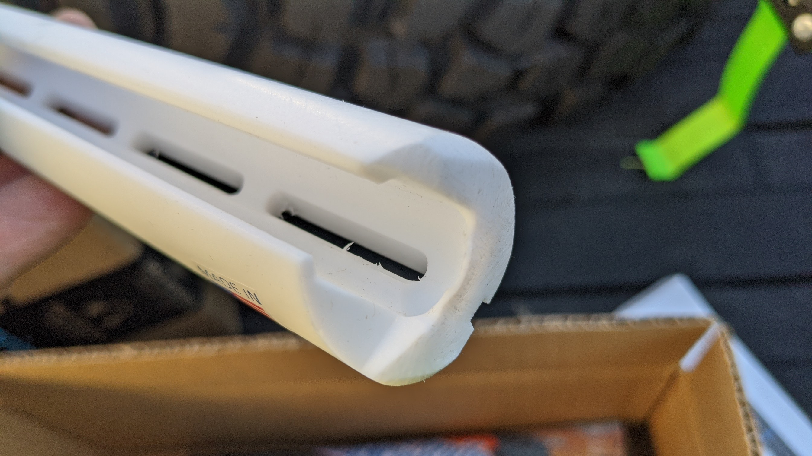

Here's the perfect example Chris..
112,568
Dear Lisa made the mistake of thinking that the Westpac low-profile 12-in took the same glide as the sapphire ti 12-inch.
we sold tons of them until one 2%r noticed and got back to us telling us the fit wasn't right.
Turns out our fabricator never actually saw the wand to fit it perfectly so I sent him the sapphire 12 and it was completely wrong yet we sold countless of them to carpet cleaners that just pounded them on and never noticed the difference.
98% of you idiots, are.

Want my address, so you can send me one?
My dry times are really good with the oversized glide.
I’d love a glide that actually fits.

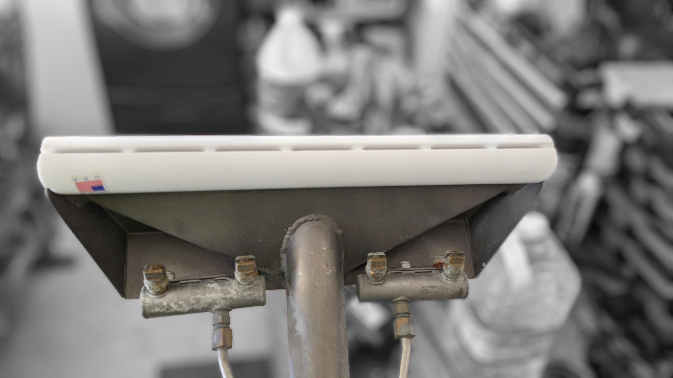

I do, however, like how the stock glide doesn’t move.
Does your glide work like that?

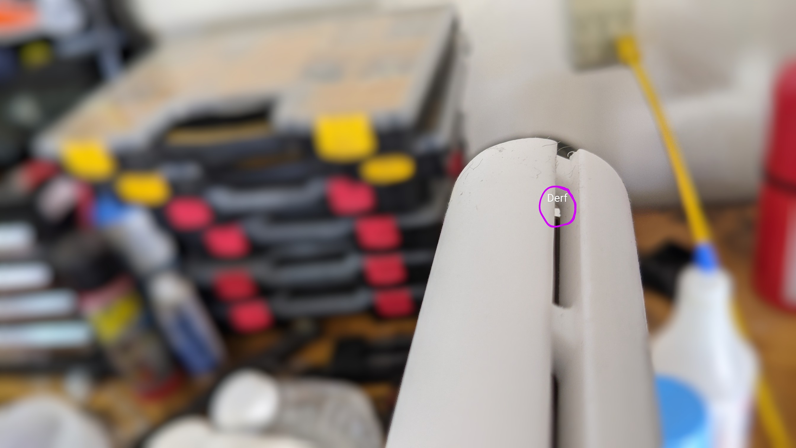

nope, that no slide feature is actually a flaw.
We design our glides to have a sight air leak on the ends to prevent lockdown
A set screw is the better choice to stop side to side play
