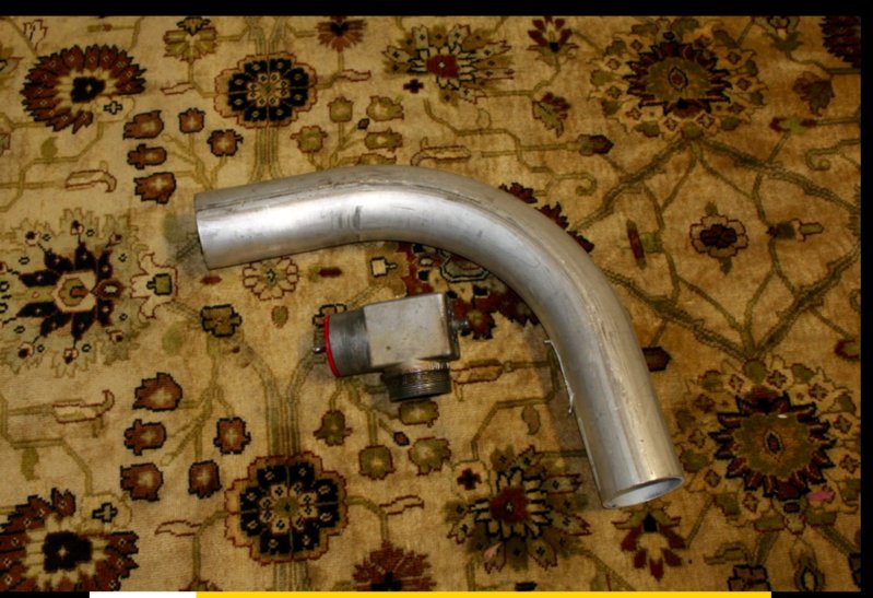

I have Thermalwave 2 with the Denver 5m and I feel I'm having issues with the vac relief valve. I've already replaced the entire piece because the neck piece that the bolt comes out of and is part of the molded box, had snapped off, from what I'm assuming was to much chattering. The new vac relief piece seems to constantly break at different levels. I've set it at 14hg and I've seen it hit 20 hg sometimes with an open wand, while other times it seems to break every time the wand hits the carpet and I get crap for suction. I also feel way to much suction from the holes of the relief valve when it's running and no hoses are even connected. That doesn't seem right either. I run 2 /2" hoses that are about 10 feet each, to a devastator and whatever is needed for hose after that. Does anyone have any ideas?

I had the guys at hotheatexchanger.com make me one. I knows it's unpopular but I mounted it on the tank. Yes i know the reasons why and don't care. I'm sure they can make you one for that spot. I paid about 65.

I replaced the whole elbow on mine and then put a new relief on my tank.
I completely opened the blower up to straight 4" so I could dual with it. It made zero difference for single wand but a noticeable difference on dual.

Interesting. I just ordered a new bolt, spring etc, to see if the other was possibly bent and causing the breaking. I'm gonna try your way next if it doesn't help, but I think I can just put the relief off the 3" pipe where the original debris trap box connected to it, instead of cutting into the tank.

They can absolutely make one for the original spot. It would be my choice if I hadn't made the other changes. Just tell them the machine and a few measurements. Your dealer doesn't have on that will work❓ Mine has a boneyard full of goodies.
