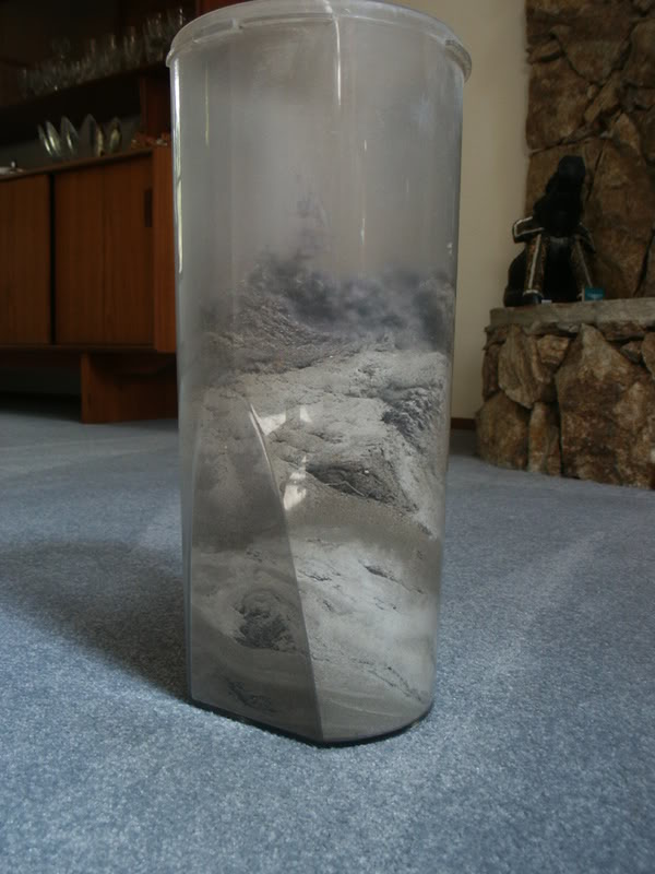

Cleaning this one room. Looked like it had already been vacuumed.
Look what came out!!
Had I been using a bag vacuum I would have left over half of it in the carpet.
What's your vacuum leaving behind??
After cleaning
117,321
Lots of lint/fibers in there.
90% of probably would have came out with the TM.
Your beater bar is set too low.

so you ucked all of that up with a vacuum and not the truckmount...
H
Heathrow
Mikey - are you saying there was no need to vacuum? :shock: :mrgreen:

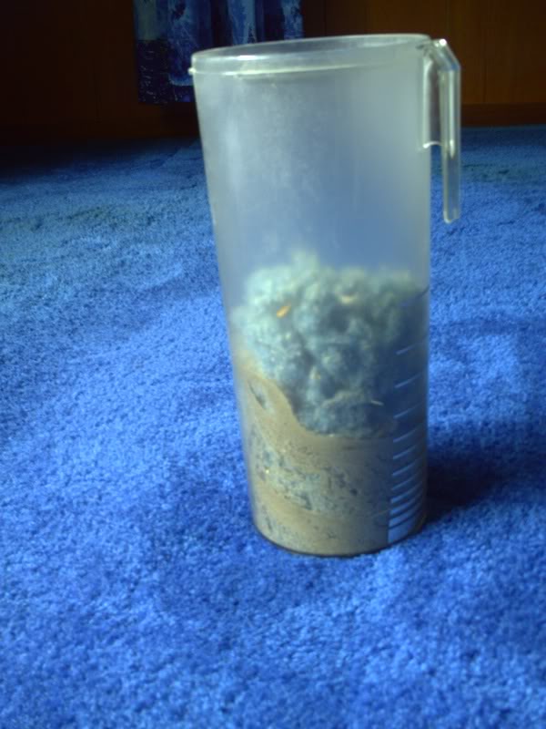

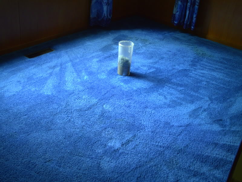

Couple more examples. Not just lint in this load. Its carpet deodourizing powder and sand. If you can't see it coming in the vacuum, you would miss this stuff entirely.
The carpet "looked" well vacuumed before I arrived. Still got this much out.
You definitely won't flush it, it ain't coming out wet!
SOme deod pwdr has chlorine in it. One local cleaner got stung because his prespray reacted with the pwdr and created bleach, stripped the dye off the carpet. NAsty!
