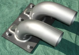

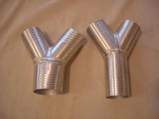

Everyone that has two 2” 90 degree elbows off the recovery should have a Y. Most of the time the Y stays 6 foot from the recovery but it still help increase flow because of the restriction of the 90 degree elbows. I rarely make long hose runs but if I want I can run 4 to the door and move that Y down the line. Greenie should make a Y that brings two 2” into a 2.5”. That way guys don’t have to modify their machines if they want to try 2.5 hose.
Greenie
6,820
Like this?

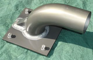

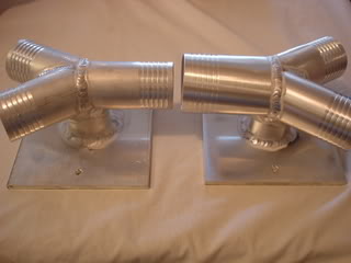

Also with a base plate:
If you really want to maximize airflow, get one of these:

Way to put my ideas into action. :p
You’re a fast wielder. :shock:
Just kidding, you’re the man Greenie!
I guess you have thought of everything.
