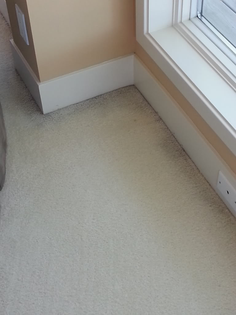

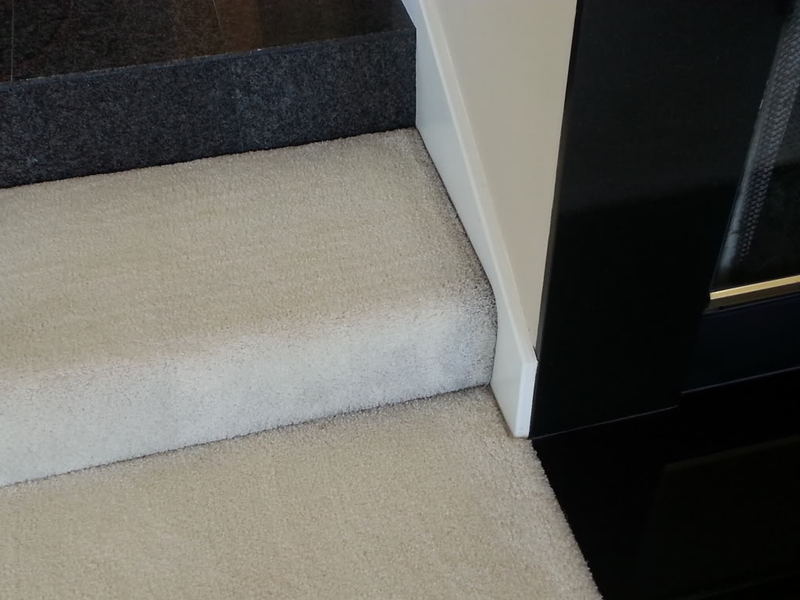

Horrible filtration staining
114,150
Along almost every wall in five rooms. Especially bad in closets. Can't recall seeing worse.
What would YOU do?

I'd squirt some purple power all along the edge, rub it in with my shoe and rinse it away. Actually I had one last week that only came out as good as yours. I wonder if some dinge away would help.

Really like Filter product from Bridgepoint. Seen a lot worse though.

Do you have after pictures? You can also use a upright grout brush with a thick rag attached to it to easily agitate the filtration lines.. won't mess up the walls.
114,150
So are you all committing to hand and knees scrubbing of all edges in three large rooms, halls, vanity, closets, steps, and moving lots of furniture to get to it all?
How much would you tack on for such a service?

If its a staircase and need to do all corners vertical and horizontal, I'd say a 100bucks. Normal set of stairs without filtration I would charge 45bucks.
